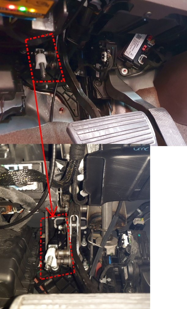

Hey Beetle,
Here's the thing. I can't find the damn cable for the brake pedal. And I'm a heavy handed guy, so I don't want to touch anything unnecessarily.
Is it the one clouded in the attached photo?
Sorry, I can't tell by your photo. I did mine 5 years ago, I was apprehensive about disconnecting the cable too but I don't recall any problems.....wished I could provide more info.

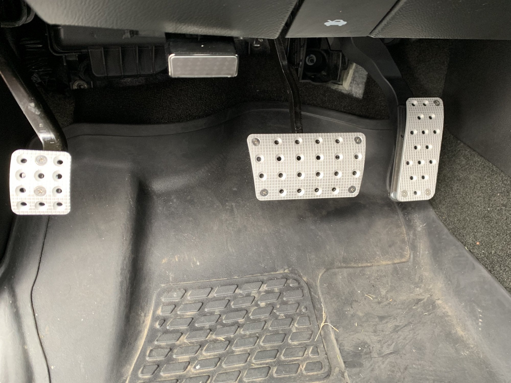

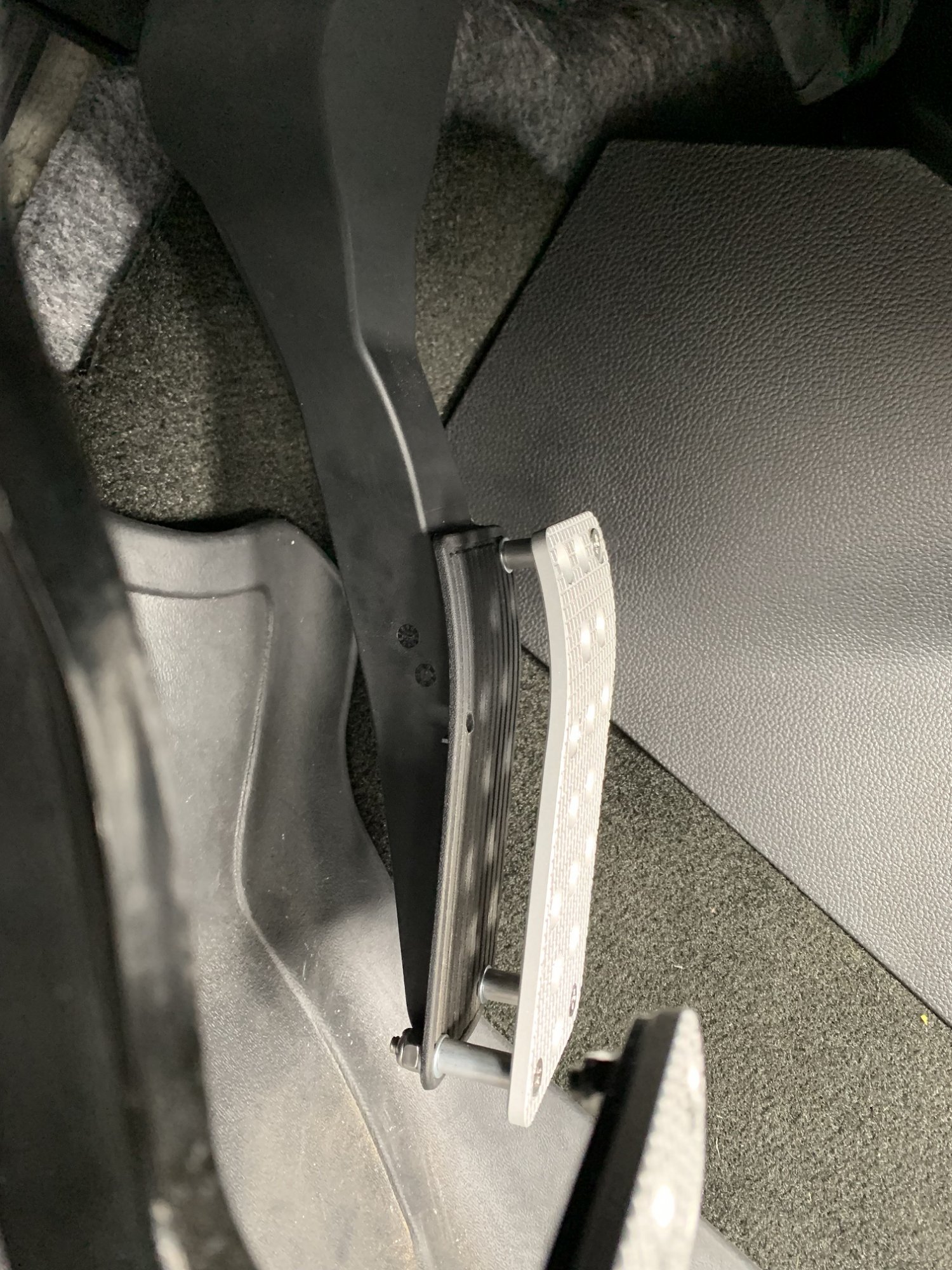

 I got some ultimate pedal covers, removed the stock rubber pedal covers and installed them (drilled into stock metal brake pedal and plastic accelerator pedal) using stainless nuts and bolts. I used some 1" or 1.25" spacers for the gas pedal. Now both pedals sit much closer together. I love the feel. Looks is whatever because I don't look down there anyway.  Or you can get a driving shoe with a thicker sole haha
