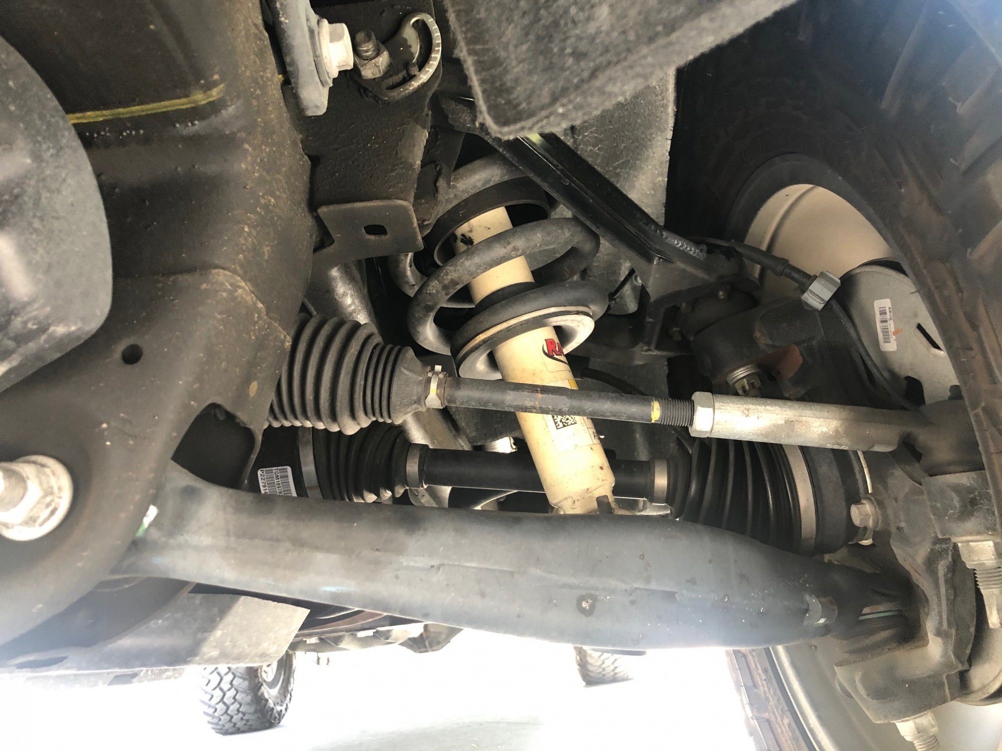

Here is a pic of my CV's with a 3" level, can anyone chime in and let me know how bad they look or they look OK?

Coil overs will present the same geometry problems as a level would. They're generally better, since there's some correction for the loss of up and /or down travel, but still gonna have the same angles at rest.
While stationary, the only thing affecting suspension geometry is ride height (unless corrected by a full lift) regardless of how you got it.
