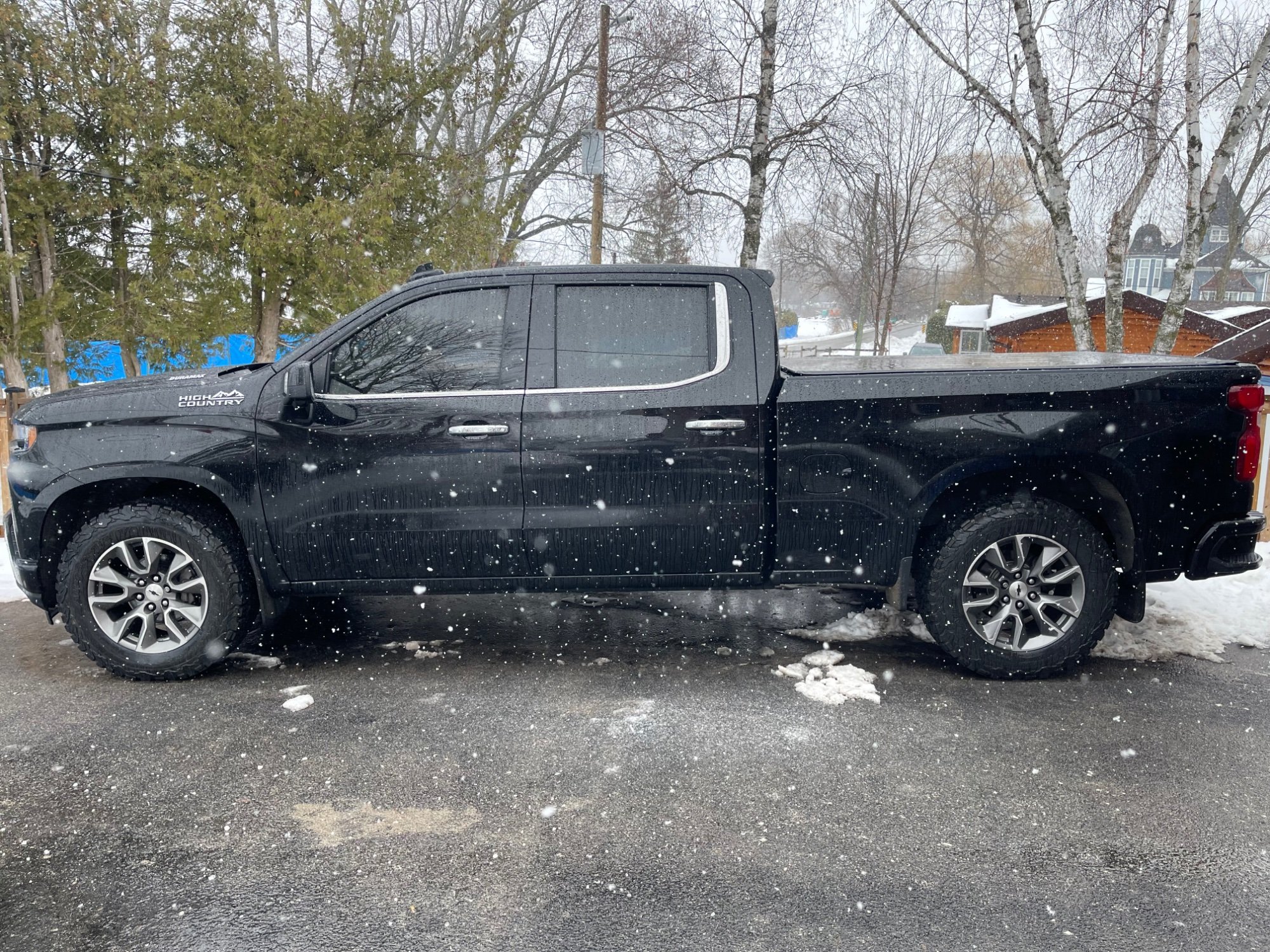

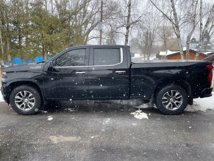

On 1/20/2025 at 1:11 PM, 3062z1 said:
In case anyone else is wondering if 285/65/20’s would fit a stock truck with no lift. They do.
2022 crew cab, standard bed. Got rid of the stock 22’s
Did you have to do any trimming? I'm assuming no rubbing at full lock?
No trimming and no rubbing at all.

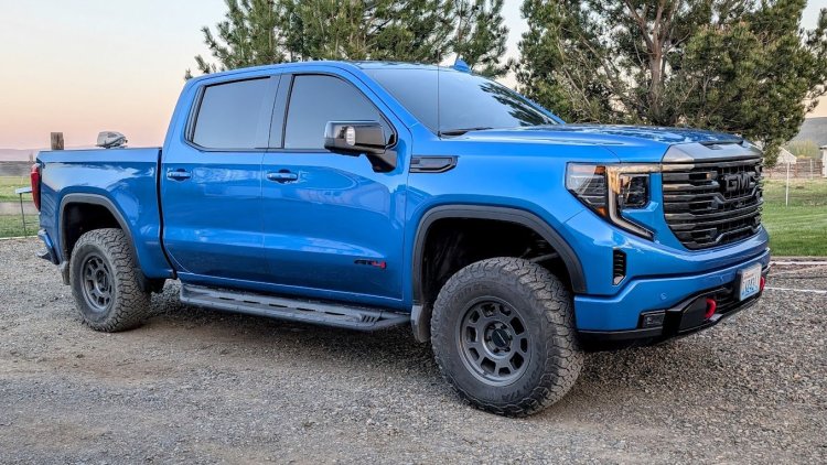

Swapped in my 285/70R17 BFG KO3s on 17x8.5, 0mm Offset Method 705s from my Tacoma to my '23 AT4 immediately after I brought it home.  The Truck has a 2" leveling kit, UCA's already, and aligned so it was a no issue install.
Drives and tows like a champ!
