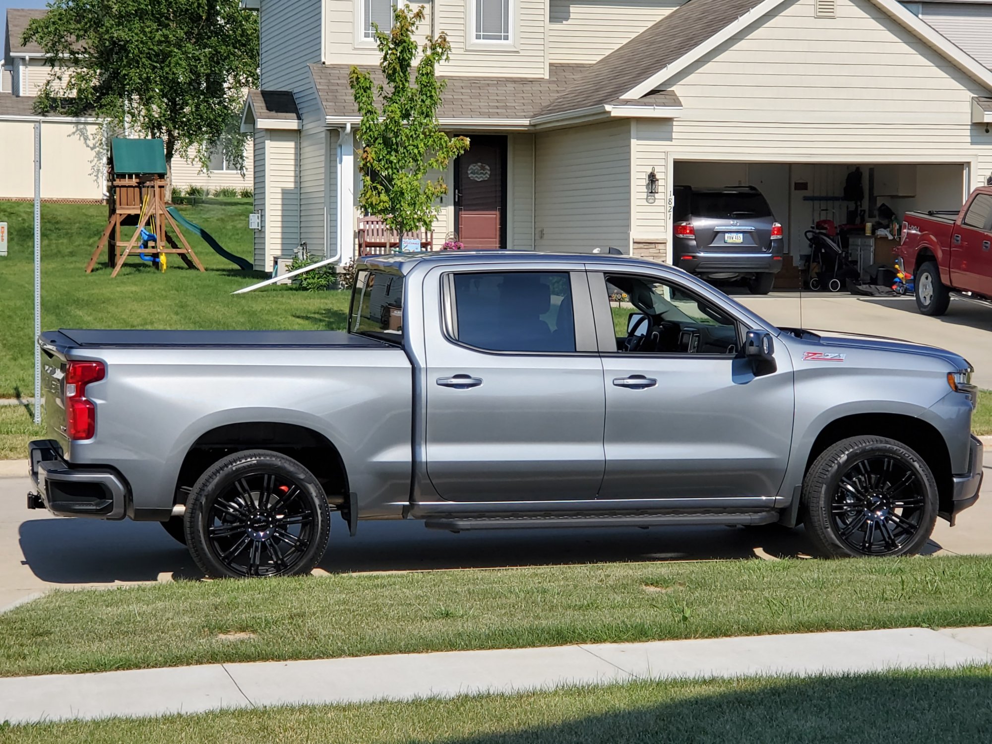

Fuel sledge 20x10 -19 (no spacers!)
Toyo RTs 285/55/20
1.5in leveling kit
Rubbing on the mud flap a lil before full turn

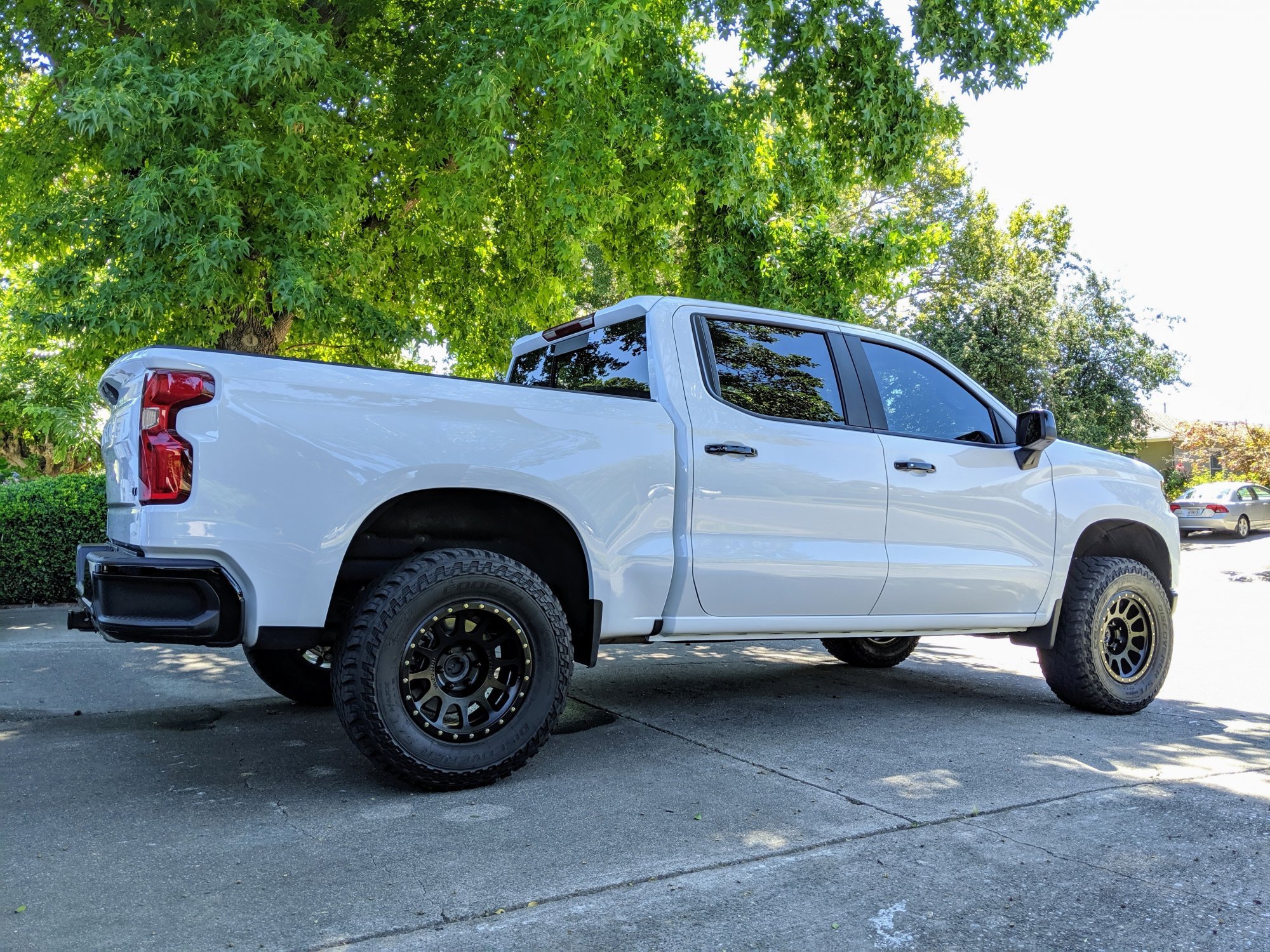

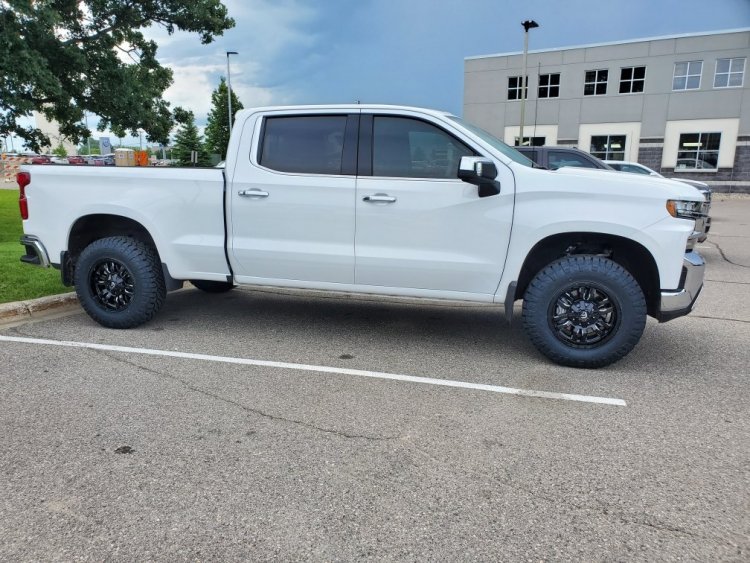

Method NV 305 18x9 -12 Offset
Cooper Discoverer S/T Maxx 295/70/18
1.5 Level (Trailboss)
Slight Rub on mudflap on full lock.

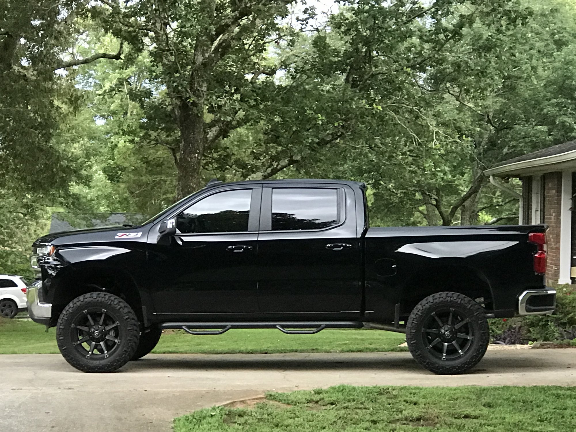

- Fuel Coupler 20x10 -18 offset
- Nitto Trail Grapplers 35x12.5R20
- BDS 6 in lift
no rubbing at all

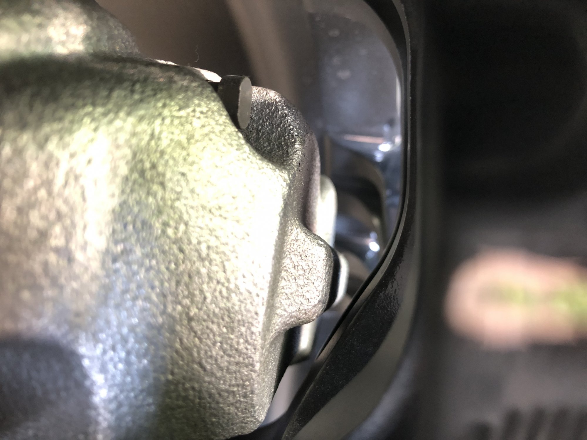

18 hours ago, BevoXV said:
Caliper clearance!
I'm not much on the '19s but that is a sharp truck.  Really like the distinct black and white of it.

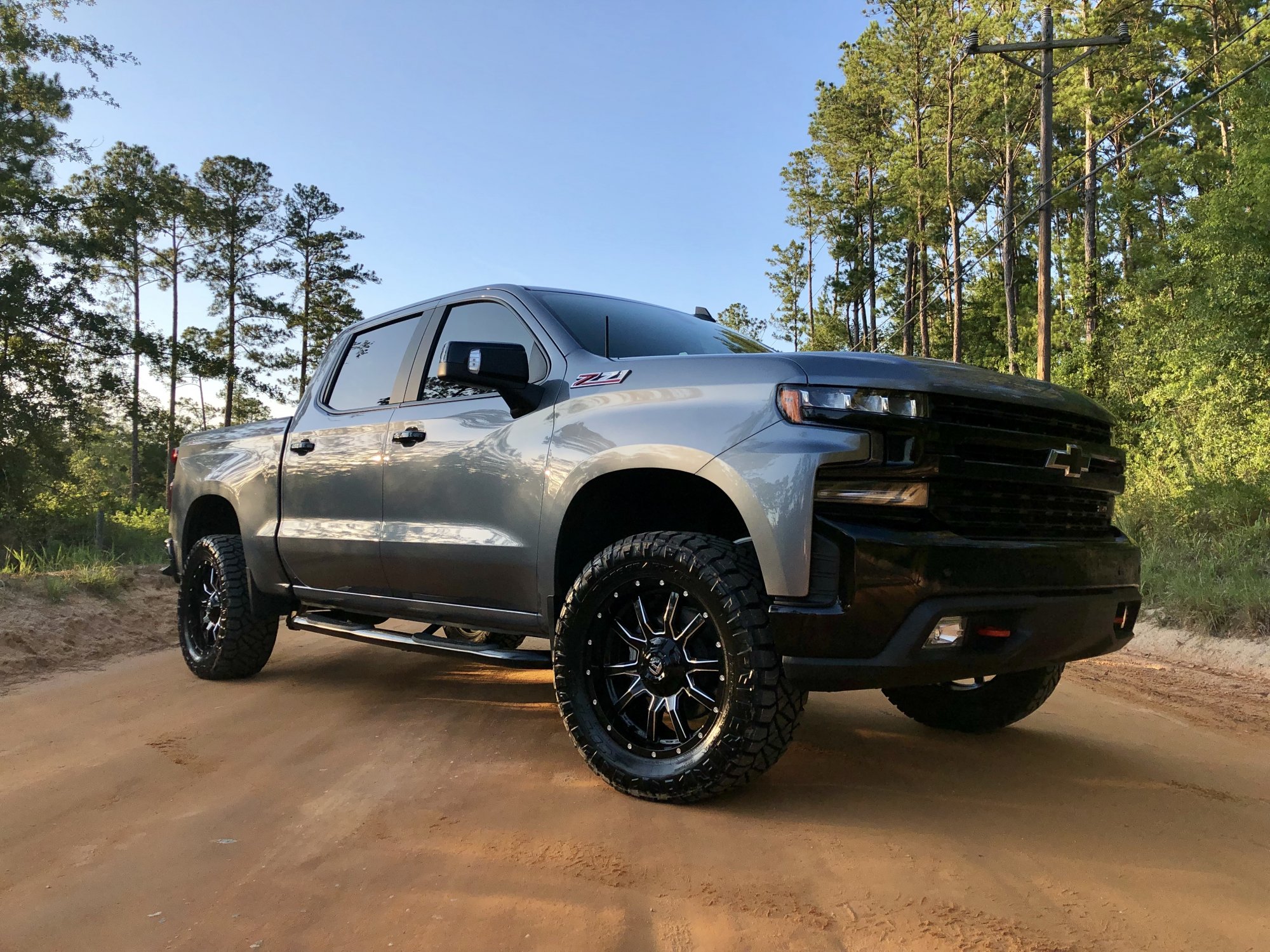

20x10 -18 Fuel Mavericks
6mm Bora hub and wheel centric spacers
Nitto Ridge Grapplers 35x12.5
2" Trail Boss Lift + 4" BDS Lift = 6" Total
Mud Flap bracket delete
Tied back the front of fender liner
Thanks man! I appreciate it
