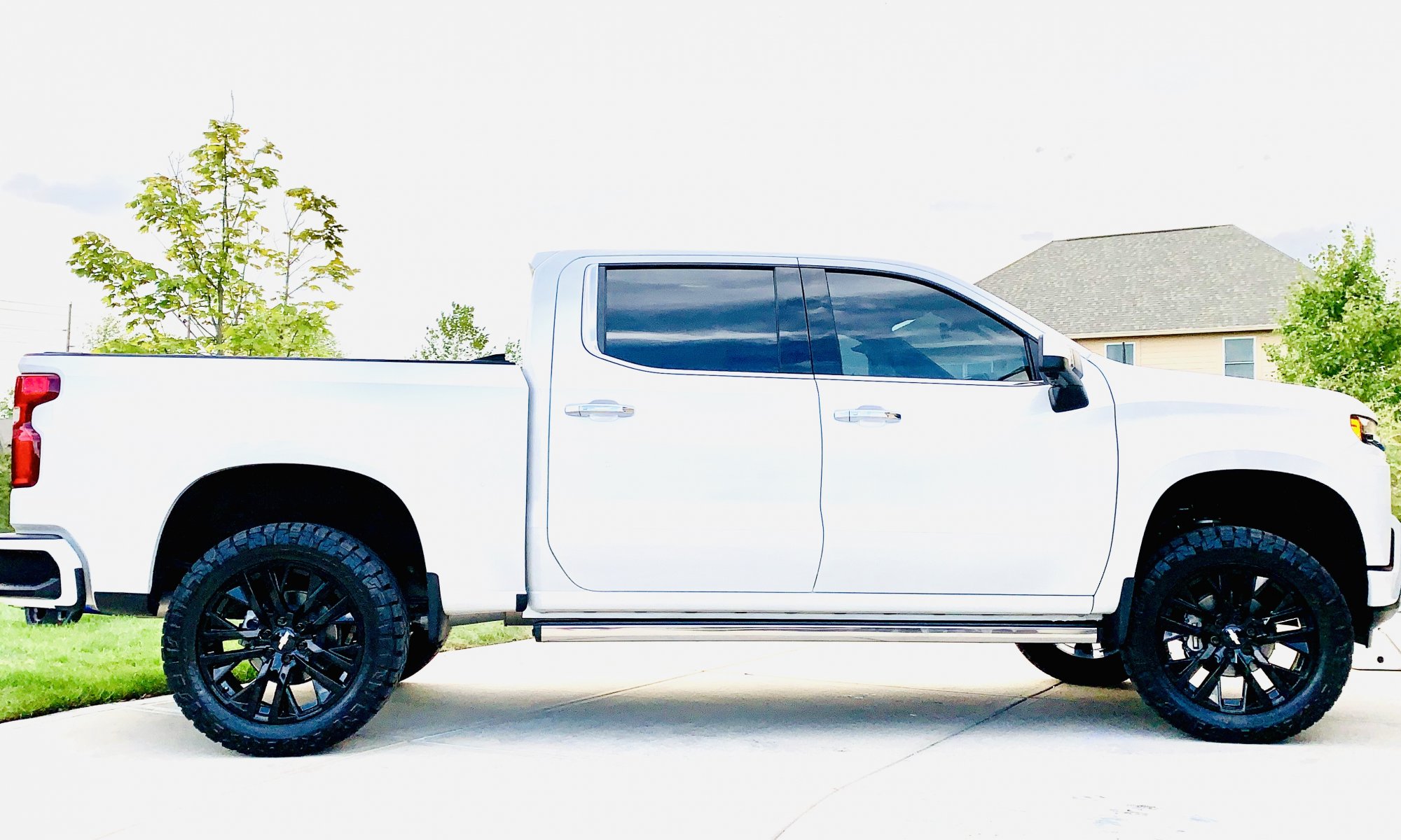

On 9/21/2019 at 6:33 PM, Ezekiel2517 said:
Looks great. Just curious.  When folks are going with 305s and aftermarket wheels, why not do a 20x10 wheel?  Wouldnt you need less backspacing then?  If seen several 305s on aftermarkets and they are all 9" wheels.
Because the 20x10 won’t fit without rubbing Or alot of trimming.  Unless you go with more lift.  Even with the 20x9 mine still rubbed.  Had to remove bracket behind mud flap for clearance.

Kept the 22" OEM wheels on my High Country and went with the Fabtech 4" lift with 285/55R22 Nitto Ridge Grapplers. Used 1-1/4 Spacers and still had to trim a bit, but not too much at all..
Looks great but you had to cut with OEM 22” wheels and 285/55R22’s? I’ve got the 3” kit and same tire and wheel set up and I have very little rub, only under certain situations it rubs, not enough to even trim. Something sounds odd.
