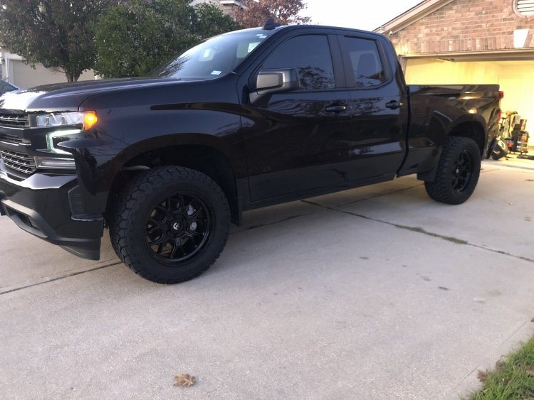

285x60x20 they fit well no rubbing
Good to hear. How do you like the ride quality of them? Did they balance out pretty well?

no complaints for the price, balanced well quite ride.Not a mud tire, Ill change them come hunting season for something a little more aggressive

Looks good. what offset are the wheels?

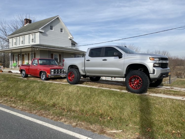

Baja kits UCAs king 2.5 coilovers
315/70r17 KO2s. Method 315s 0 offset
I trimmed plastic and zero rub after that. I'm about 3.25" higher.
So no issues with the brake caliper or hitting the UCAs running the 0 offset on the methods? Those boxed UCAs are fairly large so if you clear on 35s other brands should clear as well.
Love the look of the truck.

Thank you. Clears the calipers no spacers and no rubbing on UCAs or swaybar
