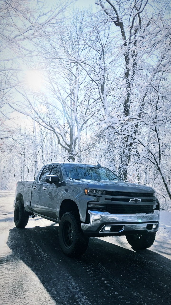

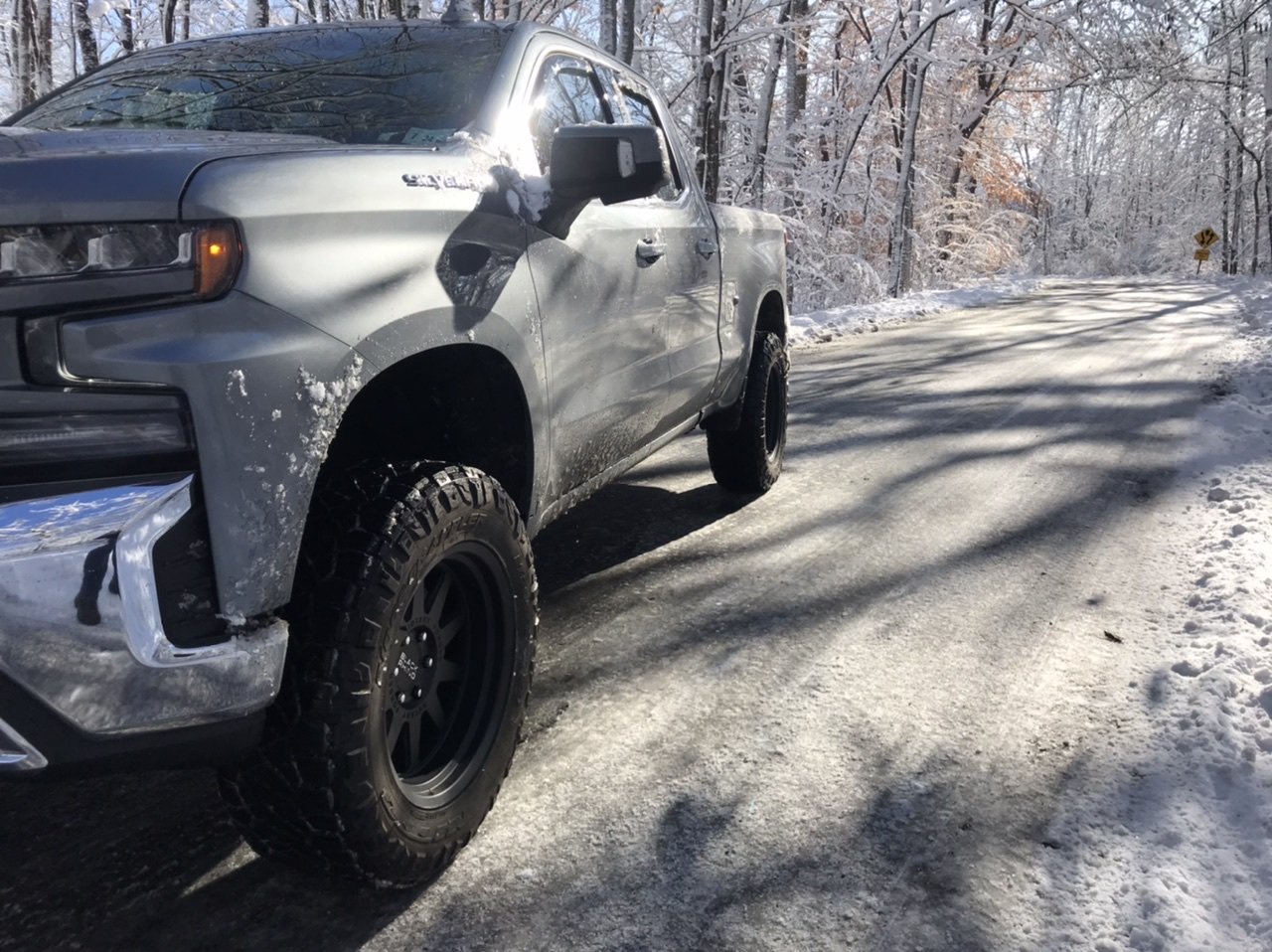

2" Motofab lift front & rear
Fuel Shok 18" x 9" +20 offset
Nitto Ridge Grappler 275/70 18
No rubbing/no trimming 60910d6b3706e96863553bcc13582685.jpg38ee43fb9792b3401cc4480641abd815.jpga724bc2653bcf6d901e107e2361541aa.jpg

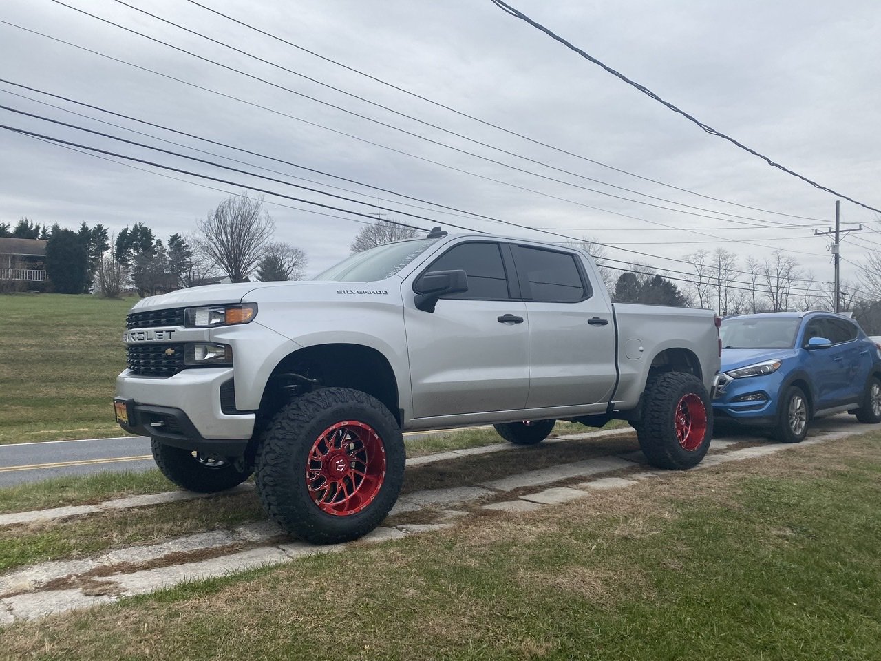

3.5" CST Lift with 285/60/20 ridge grapplers +1 offset fuel 20x9s.
no trimming or rubbing

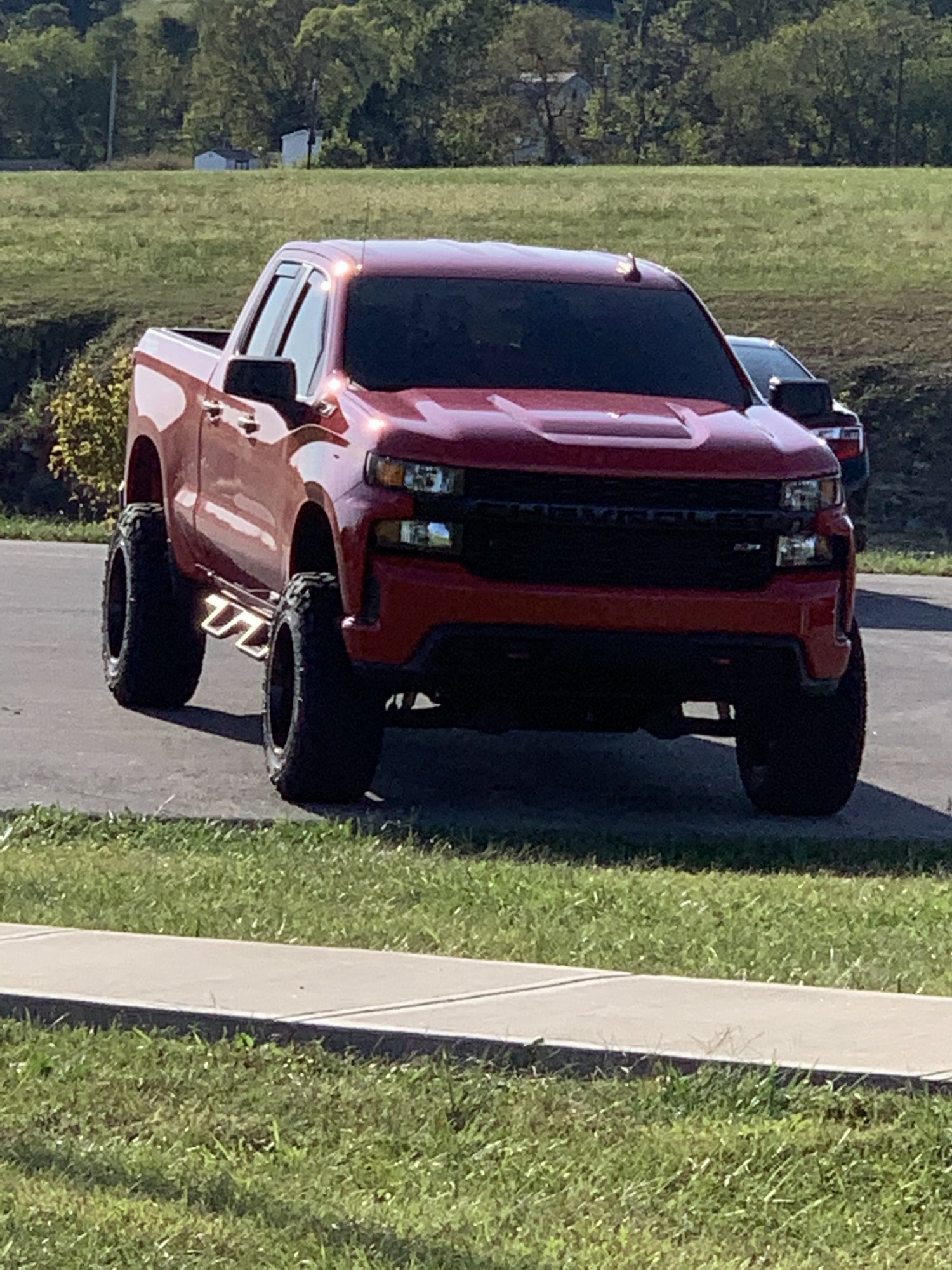

Black Rhino Stadiums 20x9.5 -18 4.5 backspace. Hub centric rings from 78.1-112.1mm
Tire size 295/65/20.
Lift Ready Lift 4” SST
