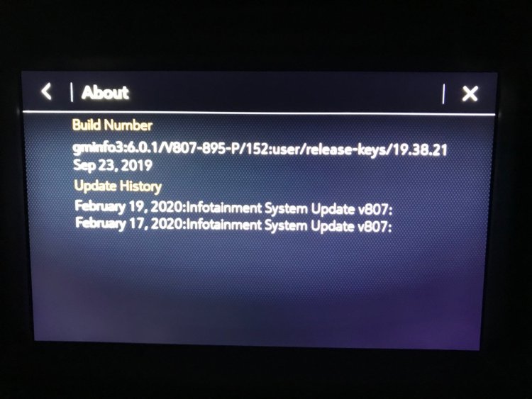

What version of software??
On 2/23/2020 at 6:18 PM, Dnt said:
Well after thinking about this could have been caused by the software update that they did at the dealership for he brake issue instead of the over the air update  or maybe the dealership one actually made the over the air possible?. I don't know all I can say is the truck has had a couple of updates in the last week and the IPhone7 volume goes back up like it should when the bluetooth disconnects now and it was NOT doing it before.
These trucks are so complicated that I am not sure if anybody actually knows what si going on with them, even the GM engineers that designed the silly things.
I had the same thoughts and updates as well, but all I know is that it's fixed on mine too.
