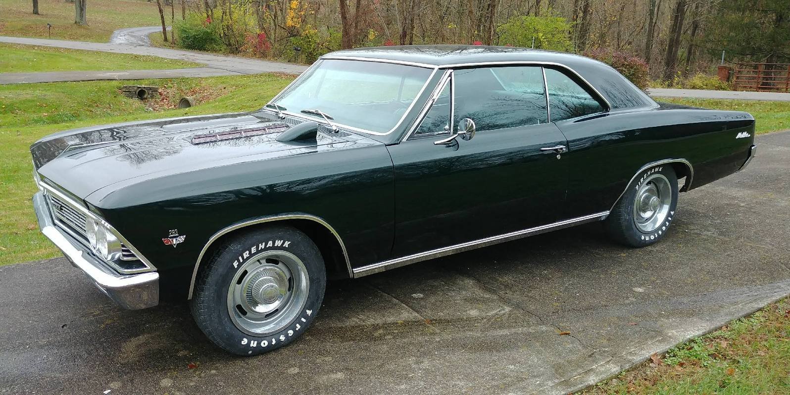

Yea I had the advantage of doing this on my Chevelle before paint so did not have to worry with the overspray much.  It was a little humid when I did it so took a little longer to dry.  I will use this in every car I redo.
1 hour ago, L86 All Terrain said:
^^ What a beauty dude. Love the 1st gen's with the hood tach. What is the spec., Malibu SS 283 w/ 4spd?
Thank you very much a lot of time and money went into this project.  THe car is a Malibu 283 2 barrel power-glide right now.
The future brings a ramjet 350 with a 700r4 and 342 gears besides that the only thing i need to finish is the headliner and package tray.  I also might do classic cragar s/s wheels with white raised letter tires.  Then just cruise the hell out of her.
