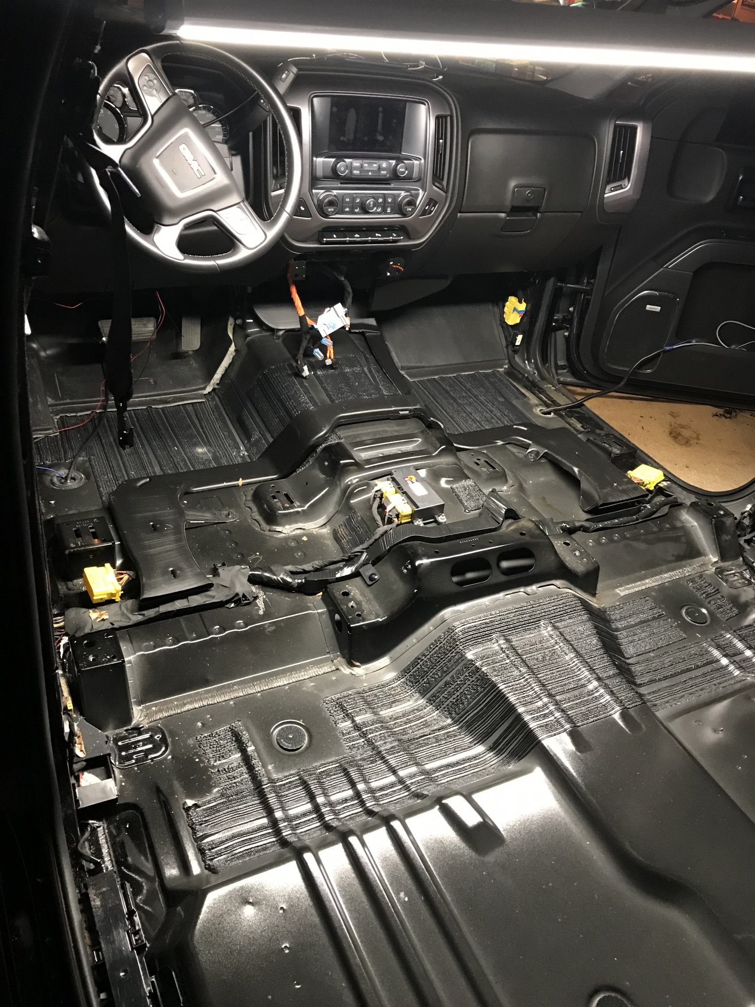

I’m putting down butyl rubber then neoprene on top. Then, I’d like to fill in some of the void spaces with foam. When I got my first Sierra back in late 2013c I agree, it was one of the quietest vehicle I had ever owned.
Fast forward to this truck + long tube headers dumped before the rear wheel and well, 95 decibels cruising on the highway at 70mph just isn’t fun. Also, after 5 years of use, every creak and squeak that the plastic parts can make, well they’re making them.
The disassembly was way easier than I thought it would be. I learned a lot. I also found a ground that was corroded so I cleaned all of them, put some dielectric grease and re-tightened. Fun project but time consuming.

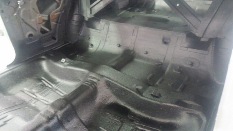

All of the exposed areas of the floor have already been insulated with butyl rubber and neoprene, using silicone as the adhesive. The reason for a liquid expanding foam product is only to reach some of the enclosed void space, like inside the pillars. An expanding foam product would be idea for that purpose. I read a lot about Lizard Skin. Seems like a really good product, but not ideal for this purpose.
I used lizard skin both the sound deadening and ceramic for heat and this stuff is great.  I'm redoing an 85 iroc now and I will use this again on this car.
