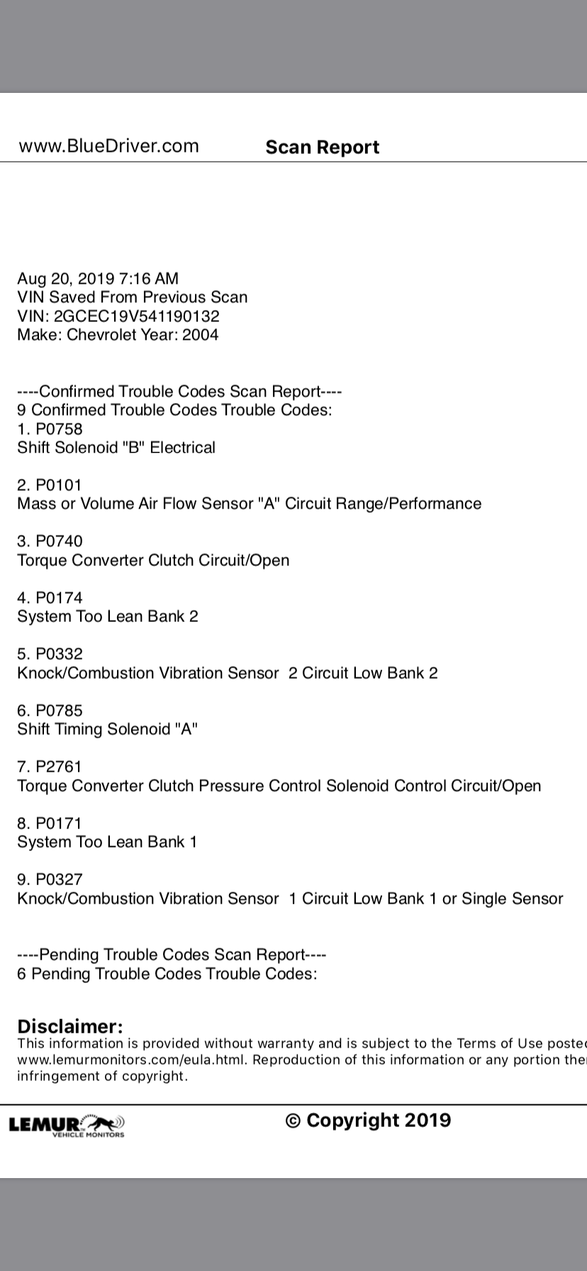

E8BF92E1-71C7-4FC7-AA20-AC31F2FE5772.thumb.png.9854bf5ddf208b11228c7bfeb3d0bdff.pngI have a 2004 Silverado 4.8 2wd and it’s been perfectly fine for the last 5 months of me owing it and last night I go to start it and it doesn’t do anything other than normal acc. Stuff. No crank at all. when I put it to the starting position the only thing that clicks is the starter relay and throttle body. I thought it was the starter so I tried crossing it and it worked fine but I still had my doubts so I pulled it and had it tested and it was fine. I tried jumping it didn’t work and I checked battery voltage and it was 12.6 so that should be fine. I went through every single fuse to make sure that some dumb fuse wasn’t causing all this. And they were all fine. I checked for power from the ignition to the fuse and from there to the starter relay when switched on and those were fine. I borrowed my friends ignition cylinder to see if there was some weird security thing but that didn’t work. I plugged in a code reader and it’s saying that all shift solenoids are bad including the one for the torque converter overdrive solenoid. And the shift timing solenoid is also bad. I don’t know if it’ll work but I’ll try leaving a link to my code read off at the end. Oh and also my blower motor is constantly on now no matter what unless I pull the fuse then it’llturn off. It’s weird no matter how much I stare at it and no matter how many tools I buy it still doesn’twork. Haha

Clear those codes and try to start it up again.

Leaning off the trans codes, I've found some info here:

I'm thinking a bad ground or bad power situation.

Everything I read is, comprised power or ground,po101,MAF won't behave with low voltage,but the blower motor staying on? ignition switch?two problems?why does everything have to be so complicated, somebody wrote a song about this
Sorry it’s been a couple days but I’ve checked everything you guys mentioned and the only thing I haven’t checked is the pcm cause I don’t even know where to start with that is there any way to test this or do I have to buy a new one and try that? I also replaced the ignition control module and that didn’t do anything
