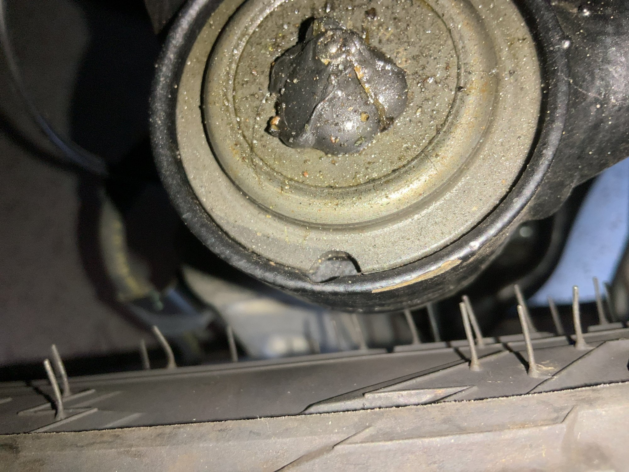

I haven't seen any but be careful with a 12.5" wide tire on an OEM 22" wheel, I'm almost positive on the 22" OEM wheels a 12.5" will hit the upper control arm. My current tires are 305-45R22's and they are less than 1/2 inch away and they measure out to be 11.6" wide.

Here is a picture of mine, it’s not an OEM upper control arm but it’s the same distance as OEM.

Why did you change them out? Lift?
