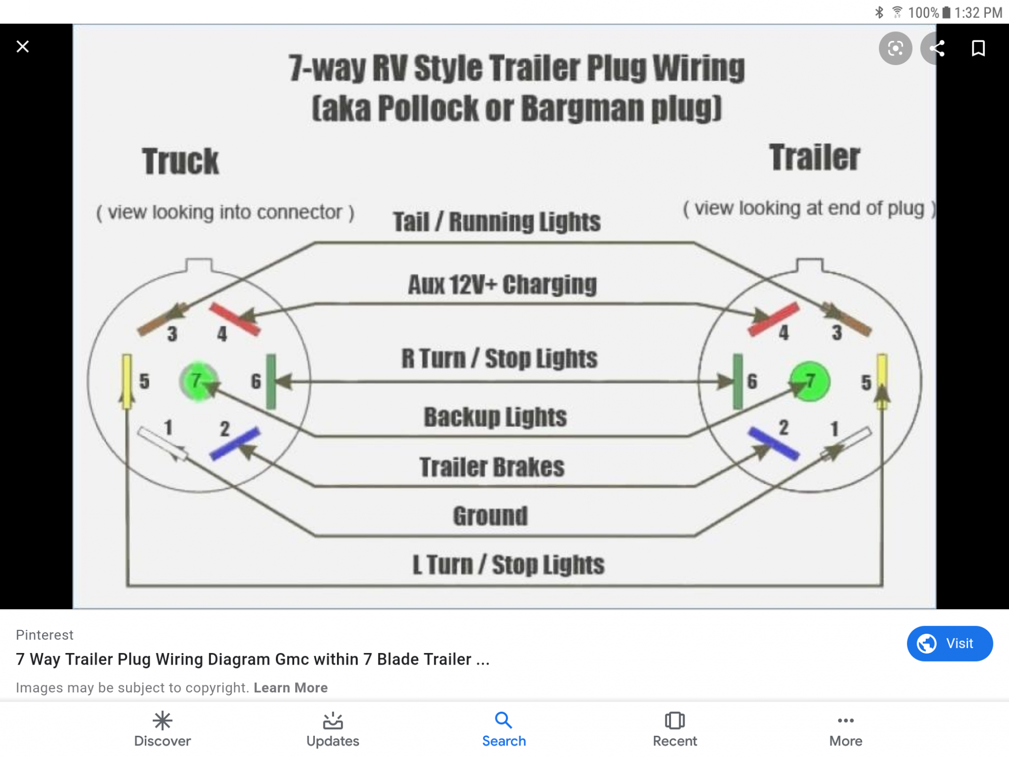

Well the Dealer Service Dept. just called and the ECM has a problem in it its not communicating properly. They will have one by noon tomorrow and installed and programmed by the end of the day. I asked about the trailer and the tech said there is a relay on the trailer battery circuit and the engine must be running to charge the trailer. It is disconnected when the engine is off.

I will check mine when I get the truck back and if it shows hot when the engine is off I'll be pulling the trailer battery fuse #63 out of the truck fuse box. I plug the trailer in at the house and when camping remotely I use a generator. The trailer batteries will hold while travelling.

I wont argue the ECM, but....
 Truck hasn't been started for a week.
That is a horrible design. They should never be on unless the key is on.
I think that's pretty common. My '09 was that way.
1) You might need 12v to the trailer and not want to run the engine
2) You can always unplug the trailer when parked without 120v hookup (common practice for some)
