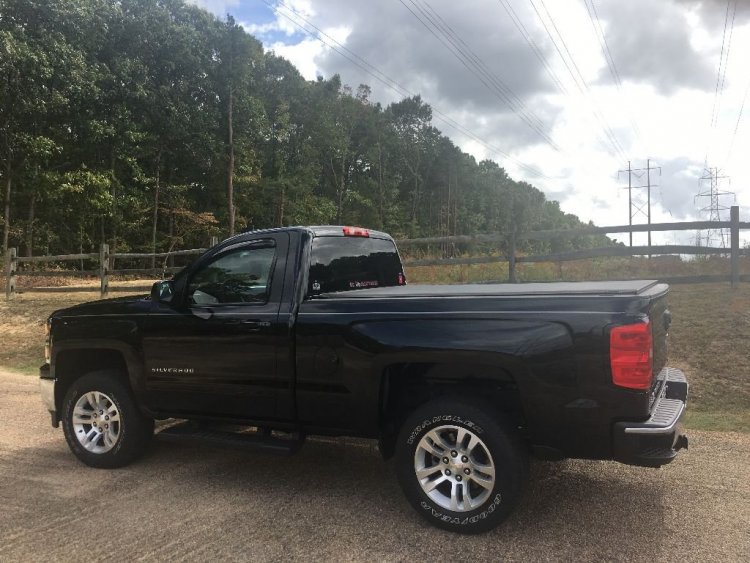

I have a 2015 Silverado RCSB.  After reading several posts in this and other forums, I've decided on the Motofab front 2" spacer and will have them installed shortly.  Simply going for the level look.  Might use it to haul on rare occasions (also have a 98 Extended cab Z71 for that).   Almost never tow.
So, next come the wheels and tires.  Currently have OEM 18" X 9.5 and they look stock. Not great, but until I find one that is, they'll do.  Many of the more visually appealing wheels seem to be more available in 20".. Which begs the question, for those of you with 2" Motofab Front Lift, what size wheel and tire are you running?  I want to keep all the wheel in the well, not extending outside, so negative offset is out.  So is such a size that will incur rubbing on any surface.  Something that doesn't look like I've got 4 donut wheels in a black hole. :)
So looking for suggestions on wheel and tire size.  that can be run without more mods.  Pics would be greatly appreciated, but any suggestions will be of help.

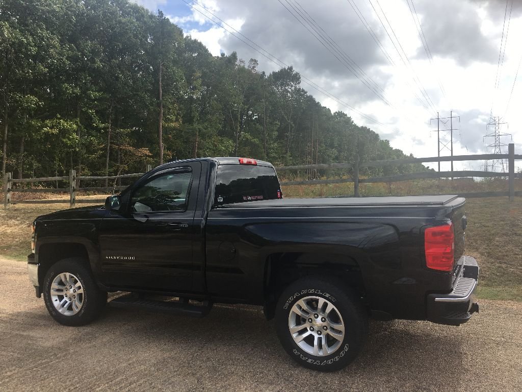

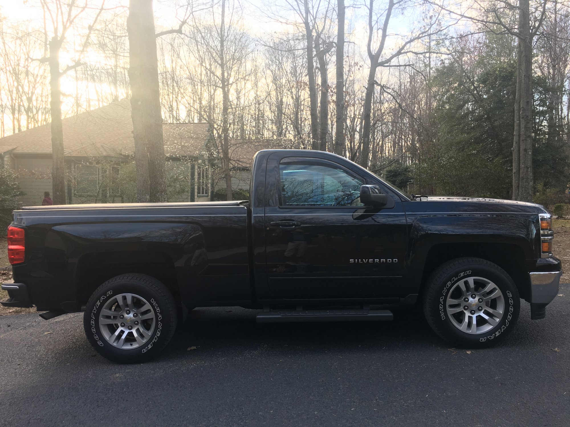

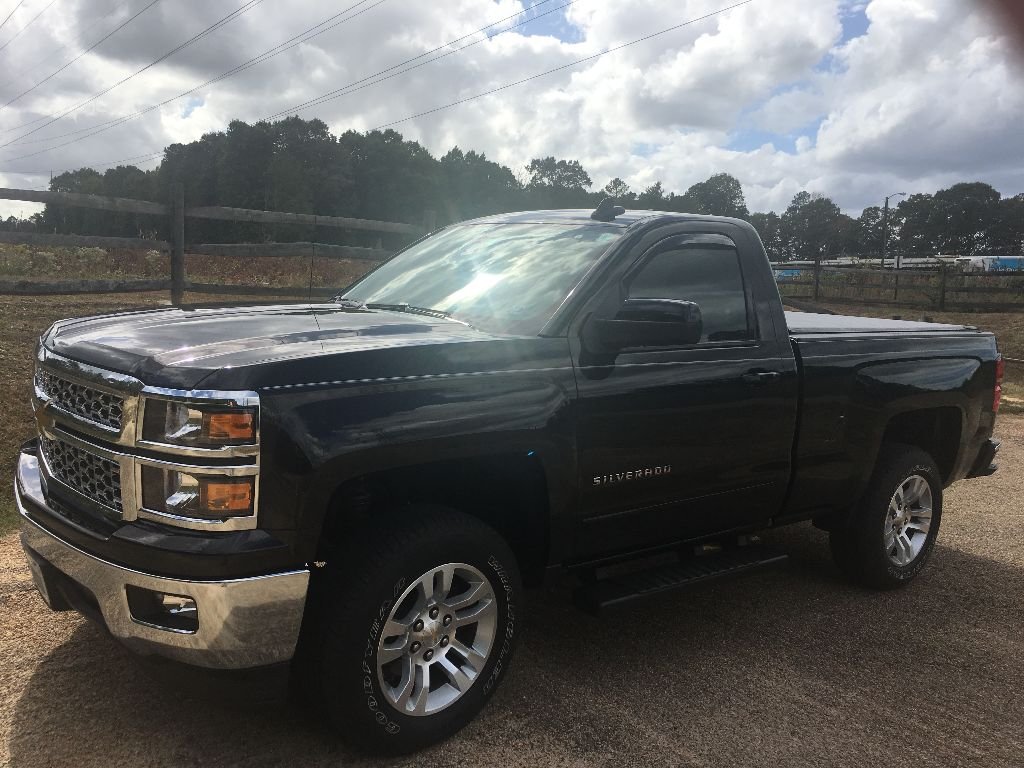

after the 2" motofab leveling kit installed. (Note that the "before" pic is taken in my driveway, which has a slope from truck's front to back)
