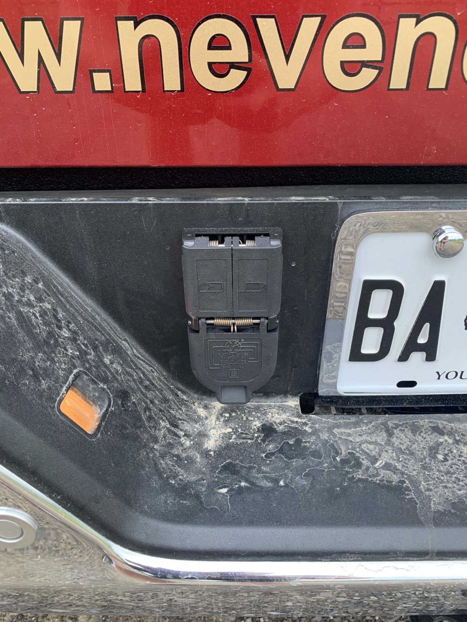

curious as well!  I would like to add the trailer cameras.  Noticed the coax cable was tucked under the bumper on my truck (didnt come with any cameras other than tailgate).  I installed the trailer receptacle with the 2 camera ports on it.  Plugged the cable in that was under the bumper.  Havent been able to get it to show up on the infotainment screen yet thought.  thinking it needs some type of programming at the dealer....  Going to get them to look at it when truck goes in for first oil chance next week.

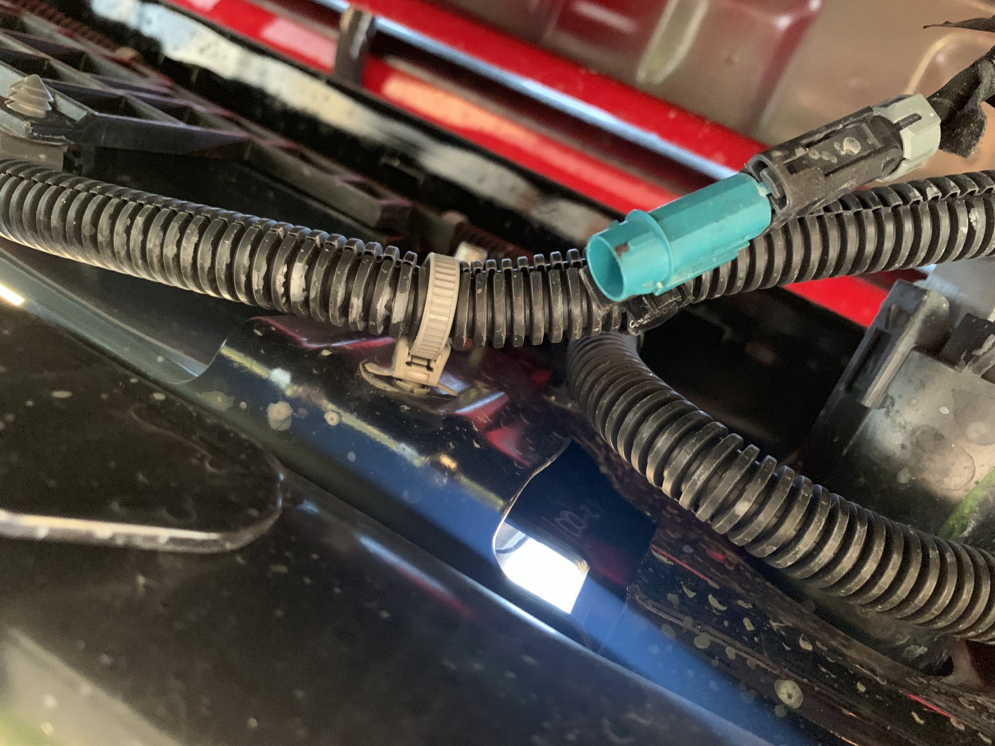

Good question!  I would think if they aren’t there couldn’t be too difficult to add...  Here is how the trailer camera coax looked under my truck. Green connector was just a protective cover.  may look similar in mirrors?
