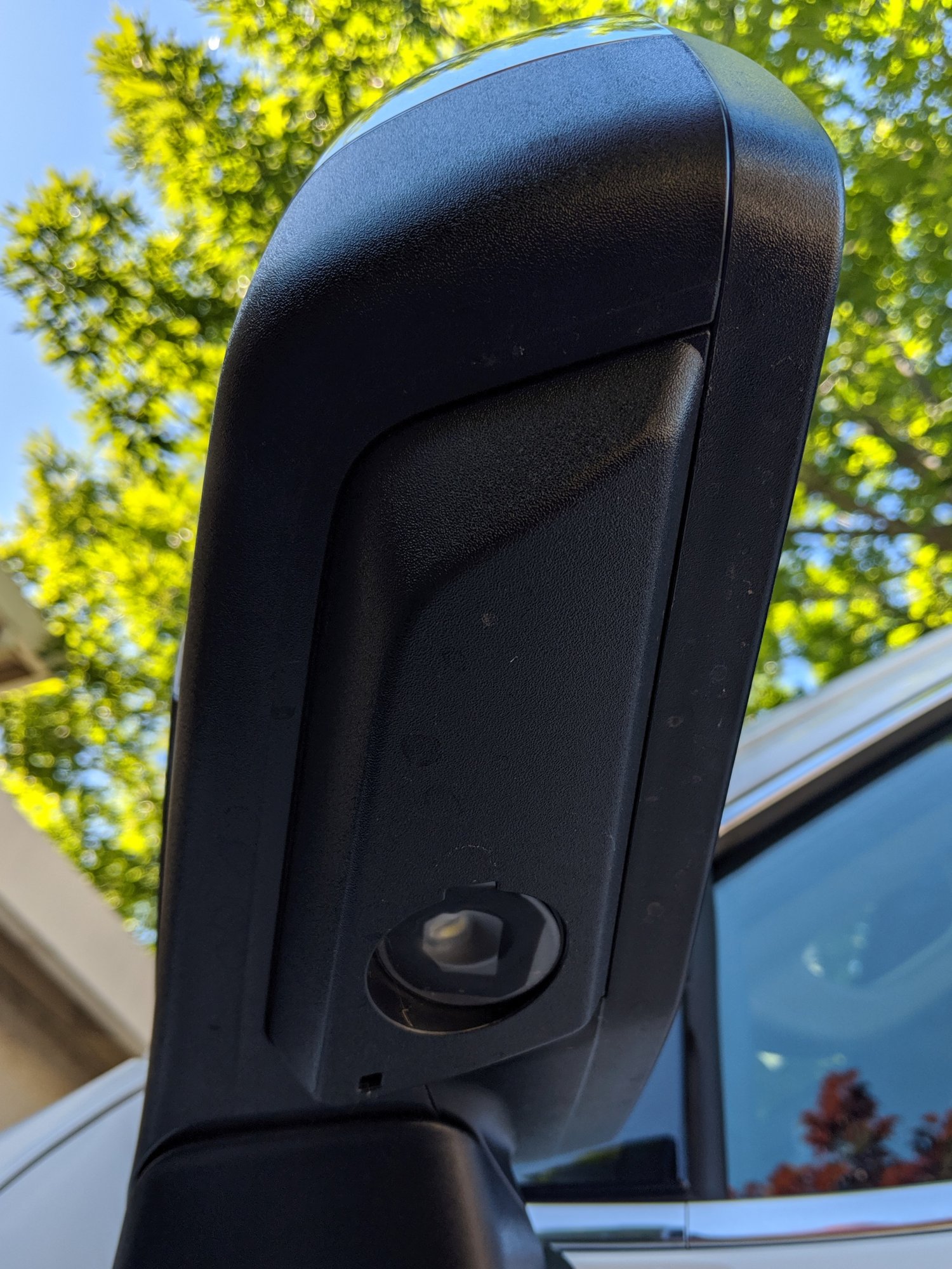

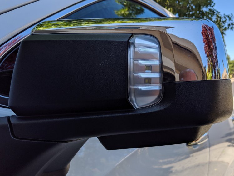

Are these the "ears" you are referring to?

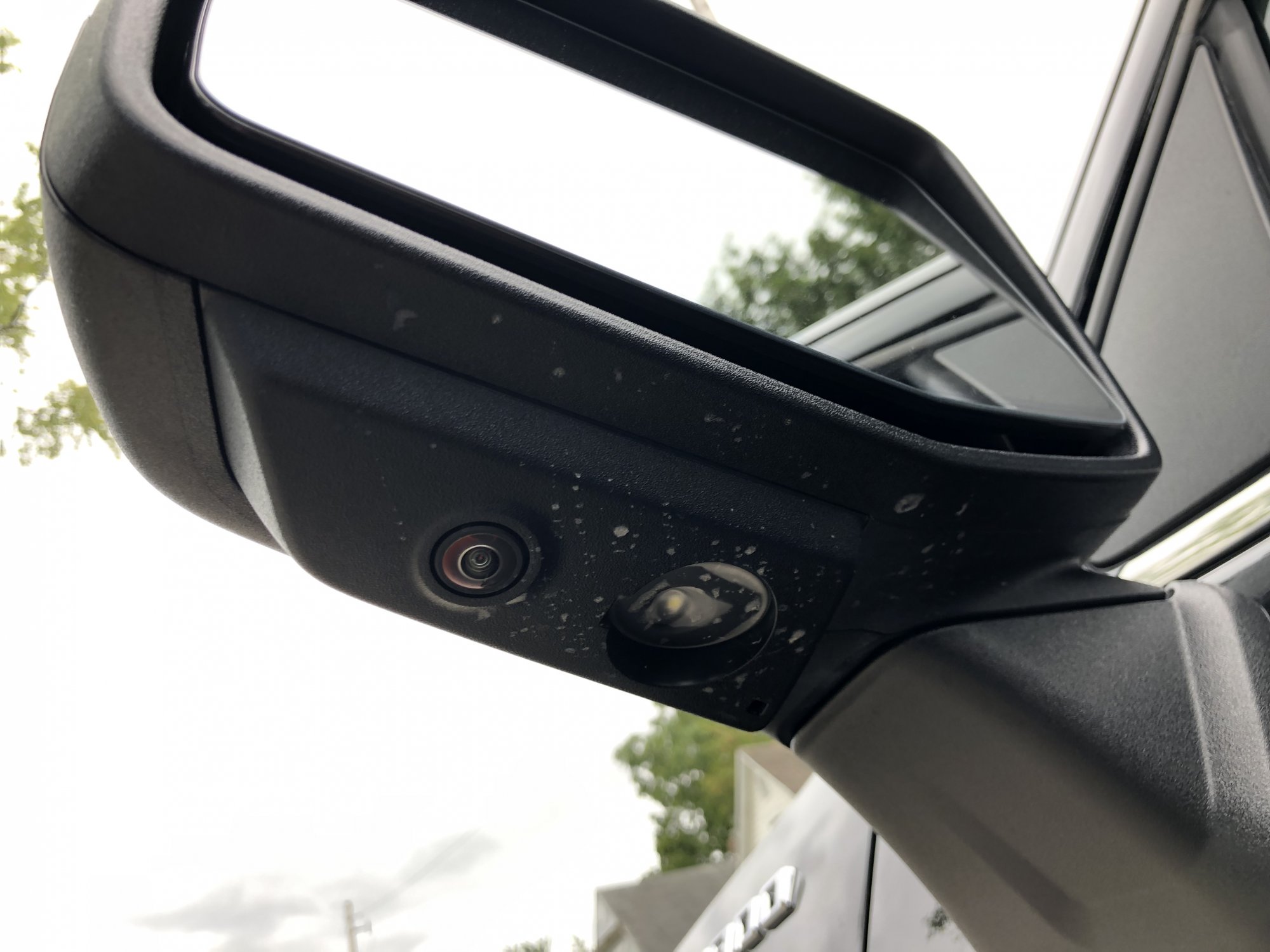

Since you have the puddle lamps in the mirror already, looks like you might be able to just replace the lower housing part and not the whole mirror. This is my mirror with the camera for reference.
Either way you can probably expect about zero help from the dealer with this.

Yep. Those are the "ears". To OnTheReel's point you may only need to replace the bottom part of the mirror with the camera module.
