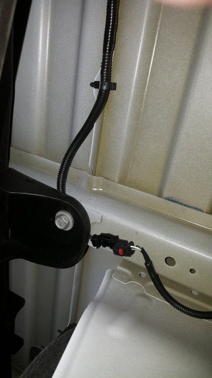

Just the other day the right side park lamps are out.. right tail light, both right fender lights and front right park light was out.    Found blown 15A fuse #42 prk lamp RT.  Replaced it and blows immediatly when I turn on the head lights.
I put the right tail light to the left side and it works and doesn't blow the left side fuse so right tail light is good.  Has anybody experience this issue?   Im taking to the dealer but just checking to see if I can get this fix instead ASAP.
Found the issue.  The wires going to the right fender  was pinch.  QC issue I guess..
