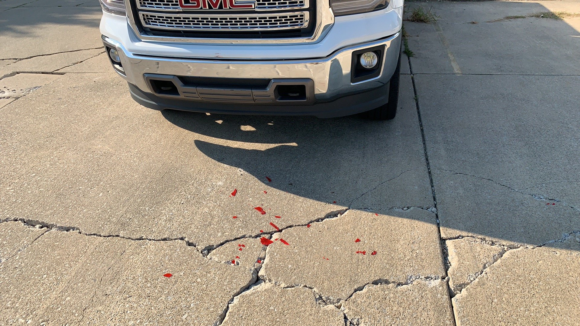

So I came out to the parking lot the other day to find some A hole had backed into my truck and drove off or parked and just didn’t tell me. I’m going to repair it as much as possible by hand because I don’t want to file a claim or pay out the ass to a body shop. How do you think I should start and what tools and materials should I need to get?

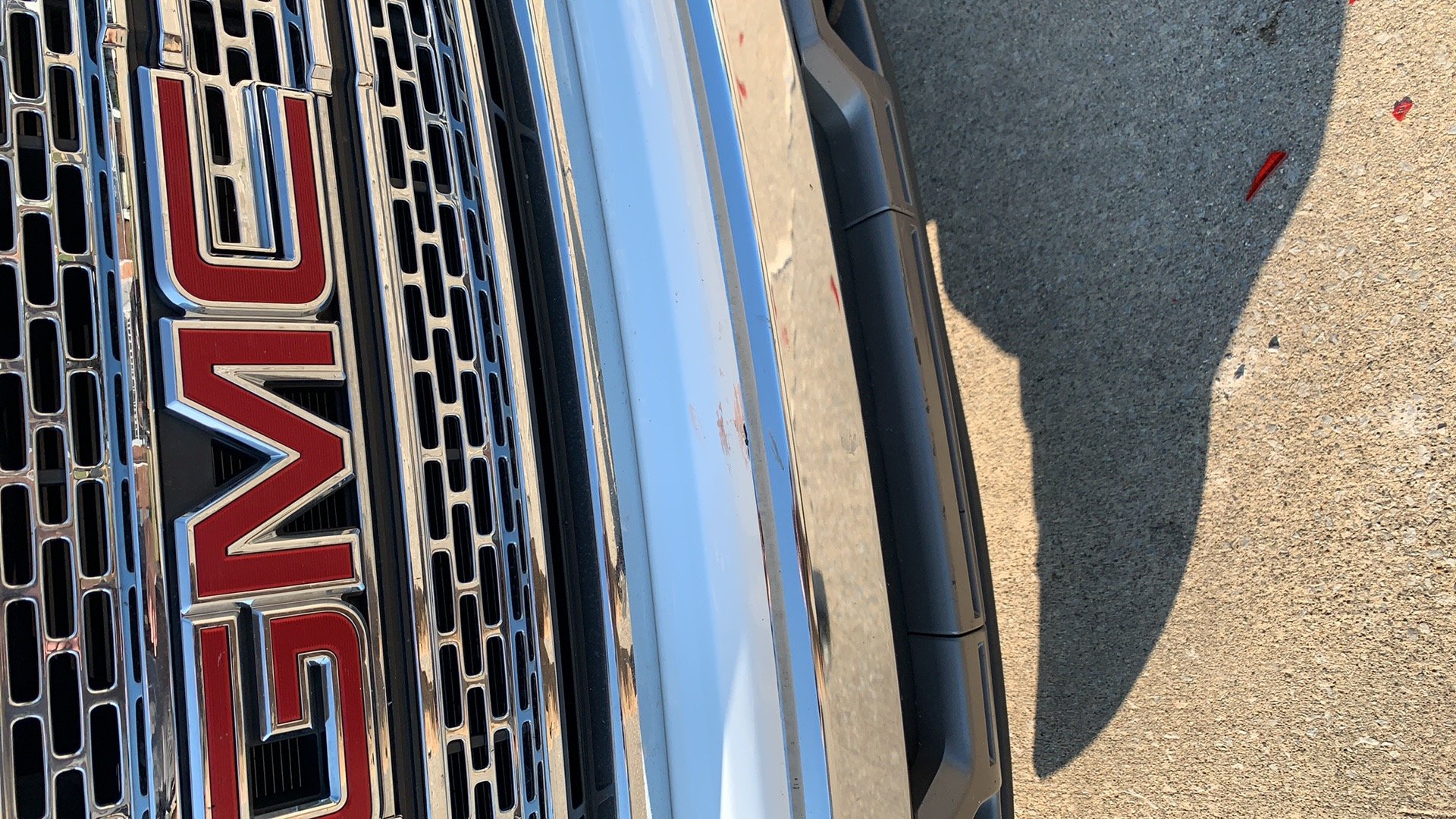

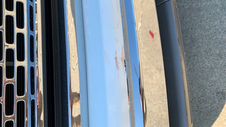

I can't tell in the pics but are there any dents in the metal part of the bumper? The rest should be able to rubbed out with different grades of compounds and polishes. I'm on my phone at the moment so I can't see too much.
Thats his taillight pieces on the ground? Start looking around for someone that parks around there (work? school?)

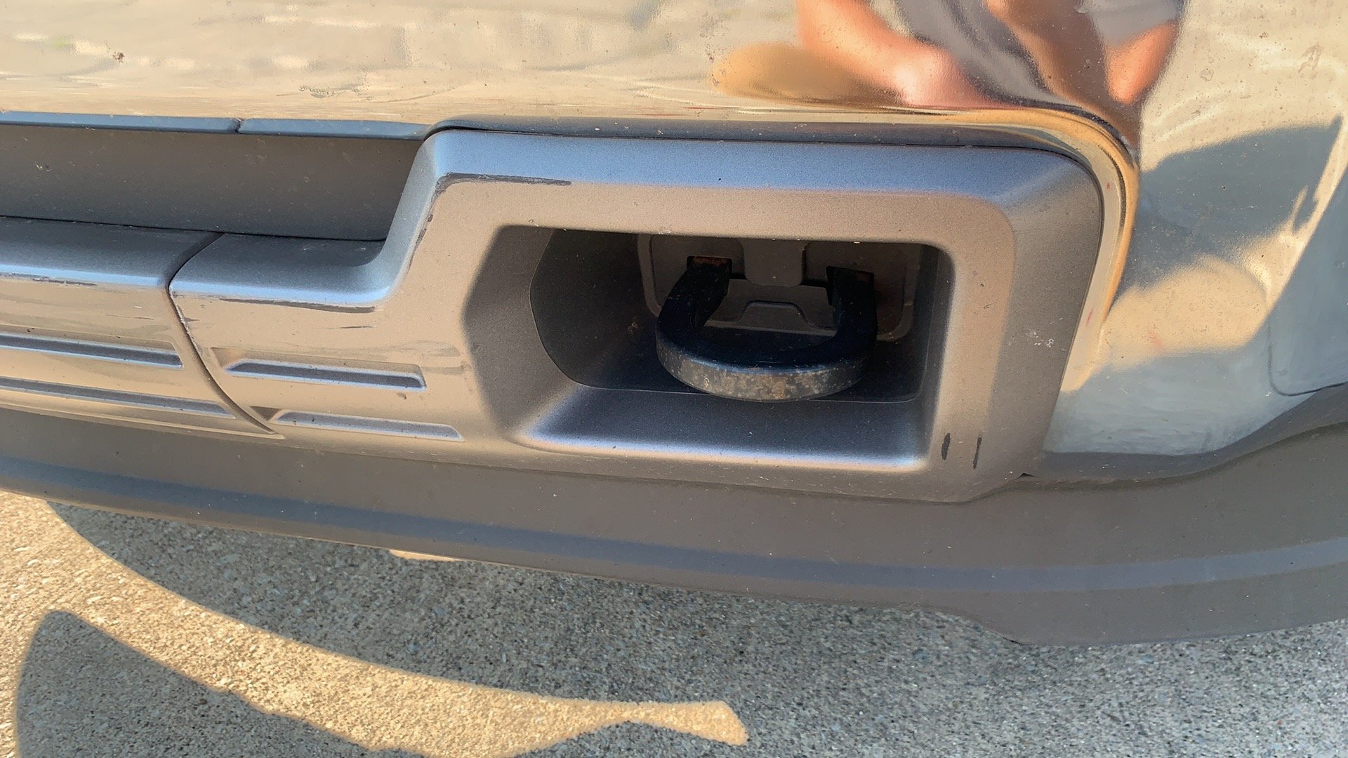

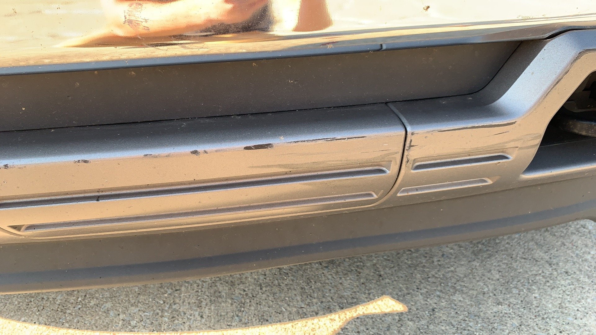

The gray piece comes out so a light sand and spray can of same or similar satin gray should be fine.
It will be hard to match the white pearl so that whole piece needs to be painted.
If you never painted anything with spray paint, youtube a tutorial. Its easy but need to know couple simple things about it. Practice on something else first then paint your parts.
Sure easy fix. I would add up price of parts and if low buy them and just bolt on. If too much and you have coverage get it covered.

Thank you for the reply’s guys.I just installed a 24/7 dash cam for the rear and front today because I’m sick of people ruining my truck piece by piece. Another reason why I’m deciding to do this on my own is because my truck is already not in perfect condition due to some dick head keying half of it. I’m going to try some wax and maybe some rubbing compound to get the red paint off, tape it off, and use some factory paint I have to fill in the areas needed. There is still some scuffing on the chrome bumper, is there some kind of chrome rubbing compound I could put on it? Some scuffing on “skid plate” as well but not too bad so I’ll try and color match the best I can. I’ve done a good amount of research and parts are still pretty expensive overall, 300ish $ used white upper bumper, 700ish $ new chrome bumper, 200ish new skid plate.
Those pieces of taillight have been in the parking lot for months, this is at my apartment complex btw. This place is by no means the ‘ghetto’, but definitely not in the best part of town either, I’ve already found another place moving to when my lease is up in March if I don’t buy a house by then. Thanks again guys
