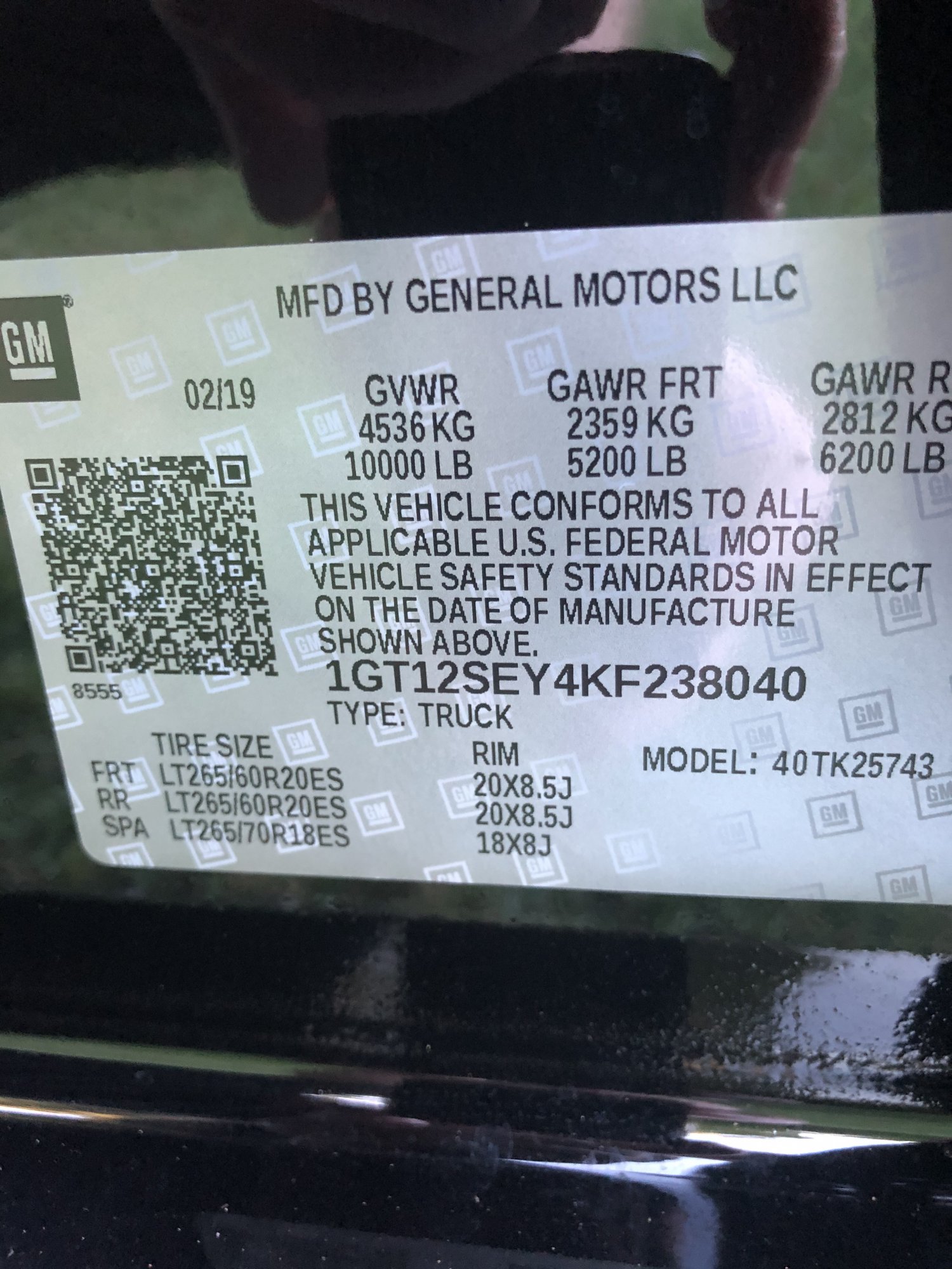

7 hours ago, mbsfgts said:
That brings up another point .... why is the front and rear axel weight combined not the same as GVWR?
I wouldn't say its impossible, but its extremely unlikely where you could hit both your gawrs.  The trucks just teeter back and forth.  If you put a snow plow on front, the rear gets light.  The front will be at fgawr but as you add weight to the rear, the front lightens where you are not at FGAWR.
