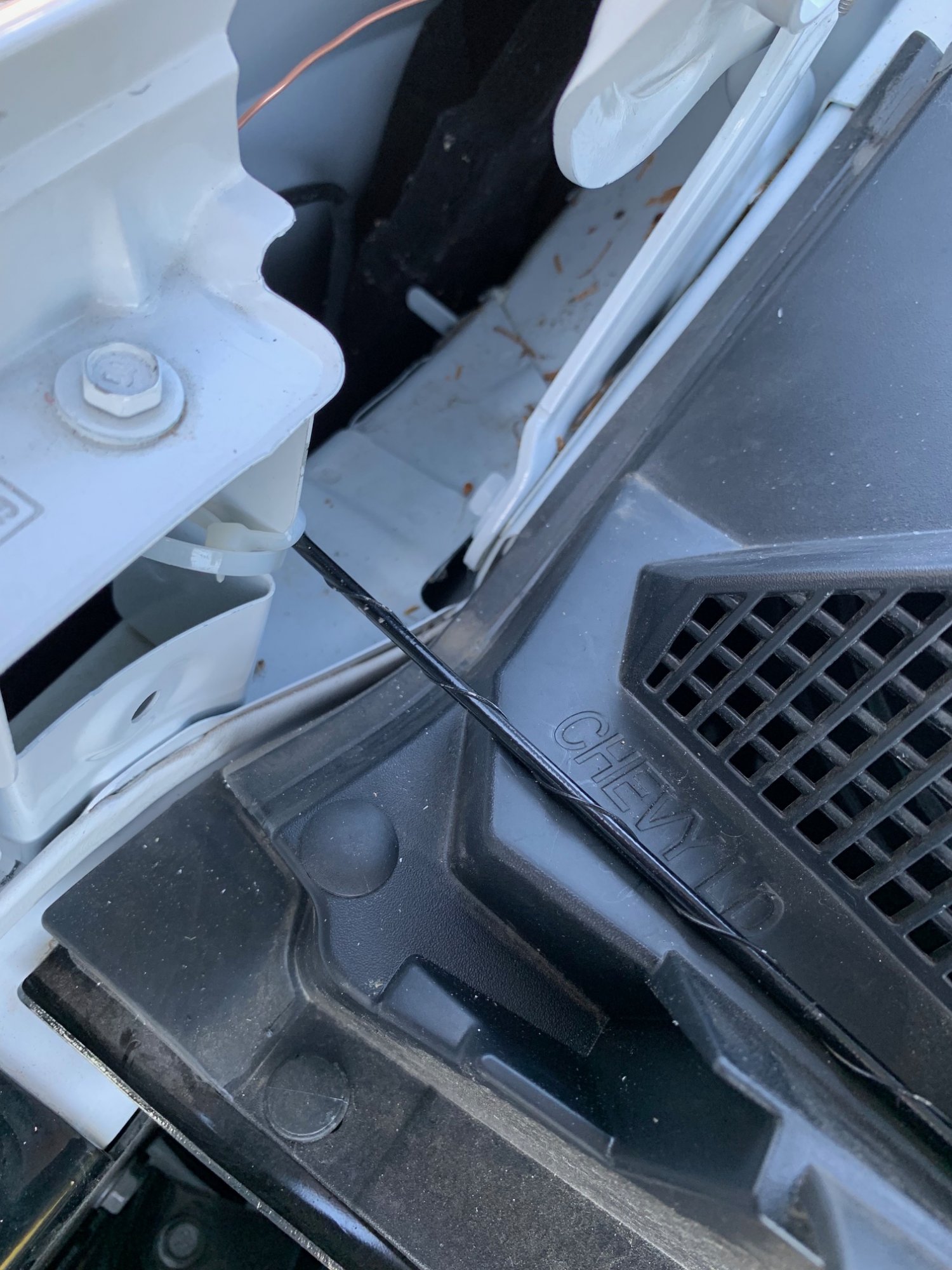

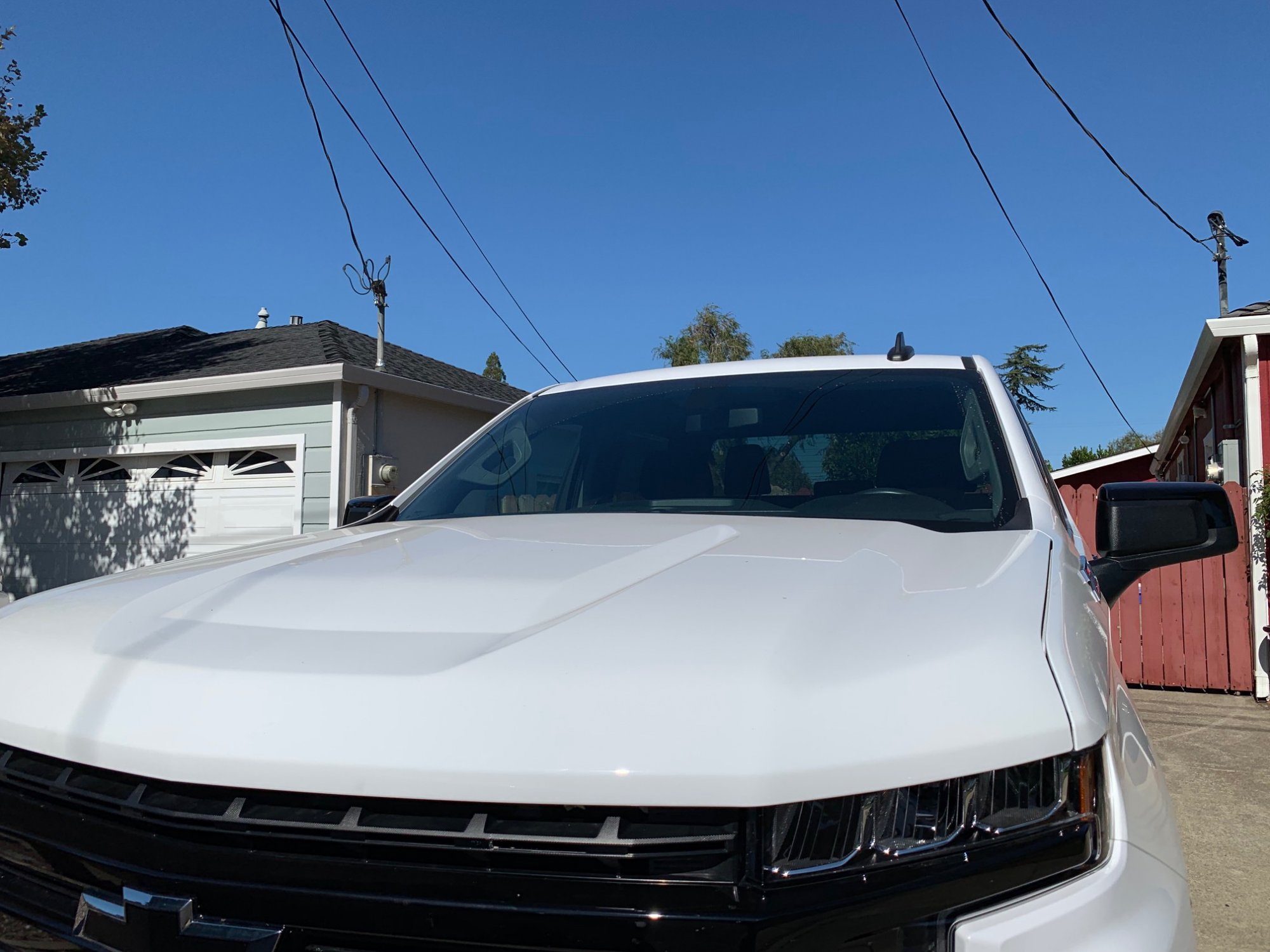

Found A simpler way to do this FM reception still good
Remove Antenna
Unbolt antenna base
Remove plastic cover
Lay antenna in drain area below windshield
Reattach antenna base
Zip tie antenna in place to grill work and hinge base
Sorry photos aren't better
