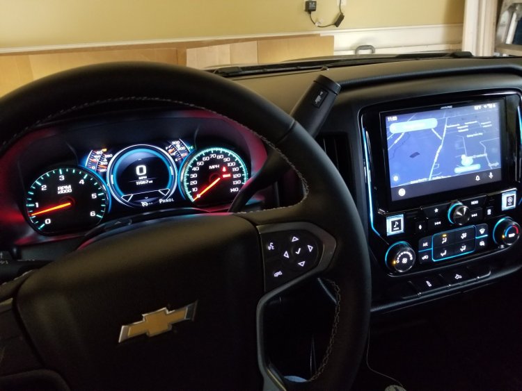

I just finished installing the Alpine I209-GM unit and the Denali cluster in my 2017 Silverado WT.  I also installed a new steering wheel with the buttons on the right side to control the cluster.  I removed the IO3 unit.
The Alpine display is amazing.  Since the display is much larger, the backup camera is much more useful.  I can also display the "guide bars",  but they don't appear to swing back and forth as the steering wheel is turned like they do in some other cars.  The audio quality is also much better.  The IO3 radio would get loud, but the Alpine unit, even without an external amp, has a much better depth of sound.  The Alpine unit also has an HD tuner so I can now pull in stations that I couldn't before.  Using Android Auto, I can display maps and driving directions on the Alpine which is becoming more important as more states are passing "hands free" laws that make it illegal to hold a phone in your hand for the purpose of navigation.
The also love the Denali cluster (a big "Thank You!" to WAMS).  I love the different displays.
Since I went with the Alpine I209-GM unit, there are a couple drawbacks.  The radio and the Denali cluster apparently do not communicate with each other.  Compass heading, radio information, and navigation information won't display on the Denali cluster.  I ran the wires from the cluster connector to the A11 Radio plug, but that plug is not connected to anything with the Alpine unit installed.  I also ran the new wire from the clock spring plug to the cluster so that the steering wheel buttons would work.  These issues are minor compared to what I have gained.  The only one that I am really going to miss is the compass heading.

Attached is a picture of the cluster and Alpine unit after installation was complete.
You stated that you put the right side controls on wheel.. are the wires in the column? I have a base work truck with only power locks and want to put the radio/nav and back up camera..which I have.. screen like my 18 3500 LTZ but I haven't found any one that can tell me EXCATUALLY what I need other than the radio/nav from another truck.  Thanks

I replaced the steering wheel with one that already had the right side buttons and the radio buttons on the back.  One wire had to be added from the clock spring connector to the cluster to so that they would work.  The Alpine unit has an adapter harness that connects to the clockspring connector for the radio buttons.
If you have the monochrome instrument cluster, it will have to be replaced with the color cluster or the Denali cluster because the monochrome cluster does not have necessary data communication capability.  I don't know much about the factory radios because I chose to go with the Alpine unit, but if you add the wires as described in the thread below and add the cluster and the radio it will probably work.  You will have to have the cluster and possibly the radio programmed for the truck that you will be installing them in.
How much did that Denali cluster and programming run you?  I've considered upgrading to the Denali cluster.  Looks really nice.
