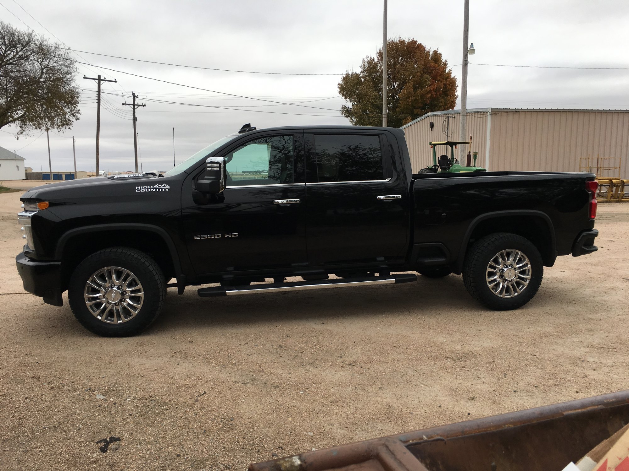

I got the XD’s on today.  Leaving everything stock the 295/65/20 rubbed more than I like.  Went with 285/65/20 G2’s and they barely JUST touch at full lock in reverse.  Wheels are 20x9 +18
