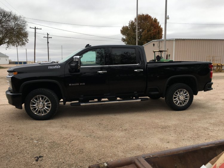

The good part is, is that the shop that installed my McGaughy’s kit did a great job of making the sure the front wasn’t higher than the rear (thank god)...
here it is after the kit

The kit was put on already, but they did a good of of making sure it was level...
