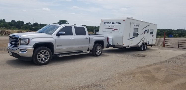

I tow mine, 24ft box 27ft overall. 6k on the scales. Stock 6.2 not a max tow either.
