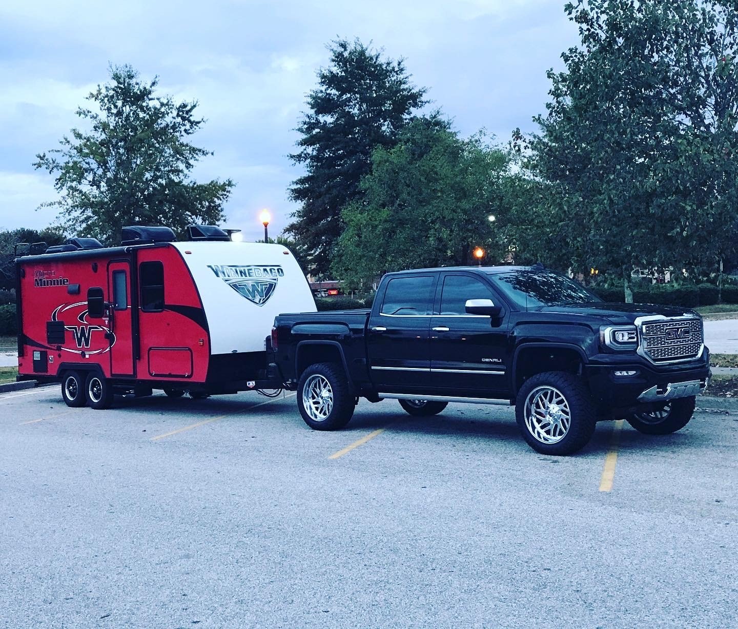

I tow a travel trailer with mine about every other weekend when I'm camping with my family and don't even know its back there. I have Kooks long tube on mine and felt a big bottom end gain along with the Whipple.

Nice trailer! 2108DS?
Thanks! 2106DS. Fellow Winnie owner?
Yes, huge fan.  We purchased a 2108DS in the spring of 2018 then traded it for a 2108TB in the spring of 2019.  This wasn't a great financial move but the bed layout of the TB model is much easier for this body to get out of in the morning!
Excellent. We just bought ours and love it. Easy to tow and great quality
