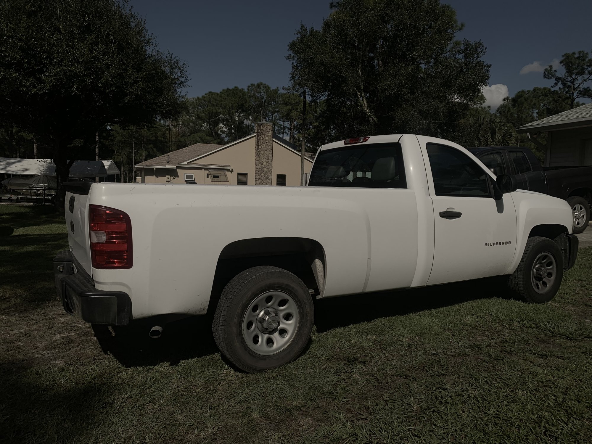

Long story short, my father acquired a 2011 Silverado 1500 with the V6, for free.
It has 220k miles of which the vast majority are highway, and runs pretty well at the moment. According to the original owner, it has had 0 major mechanical problems.

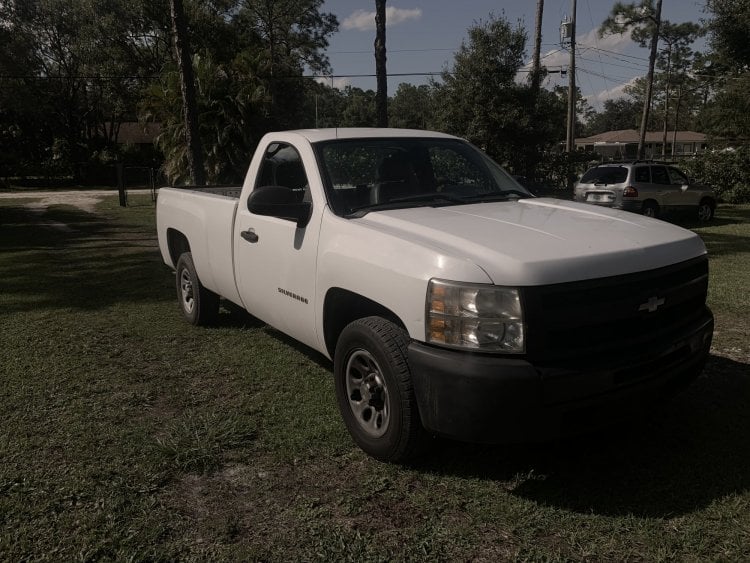

This motor is as reliable as a stone axe. 200K is just getting warmed up. But yes. Cam GTP is on the money. Body look nice. How's the inside?
I would love it if it lasted them a bit. It's not a bad looking truck. It was a work truck in my dads company and they upgrade every so often so my dad's boss just let him keep one of the old work trucks.
The inside has a tear on the drivers seat, but other than that it isn't trashed at all. No one really sat in the front seat ever and nothing is cracked on the dash or anything.
