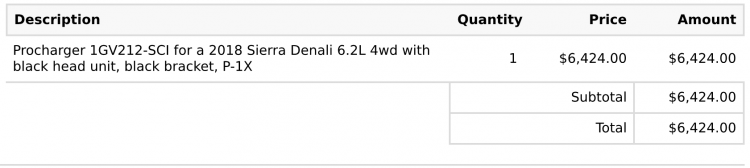

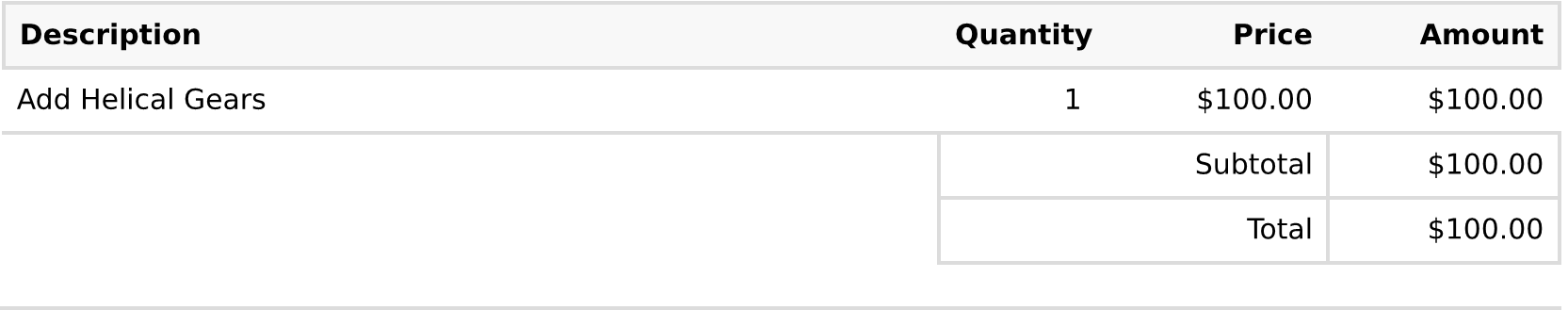

cost breakdown

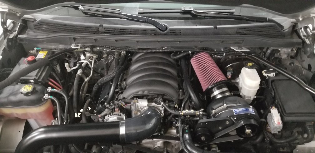

10 HRS. LATER THE PROCHARGER IS IN AND IN THE BREAKIN STAGE.

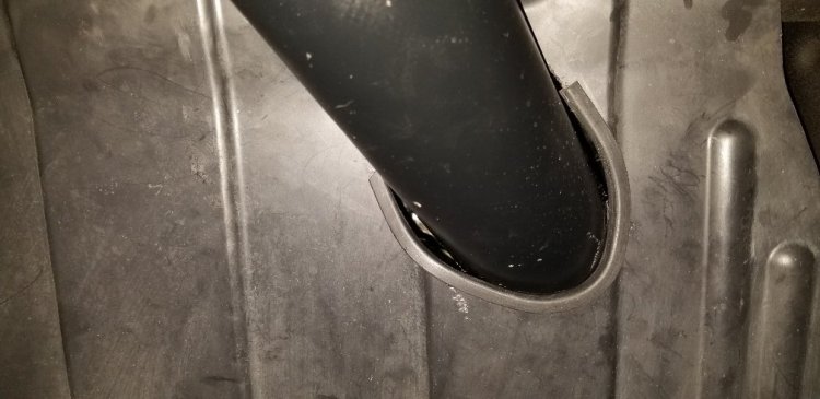

FEW CONCERNS I HAVE ARE ATI STATES THE SURGE VALVE IS NOT DIRECTIONAL BUT I FLIPPED IT EACH WAY AND FELT A NOTICEABLE DIFFERENCE I HAVE NOT INSTALLED ANY GAUGES YET BECAUSE I HAVE NOT FOUND A SET I LIKE THAT MATCHES THE GAY BLUE FROM 1985 OEM GM'S. MY 16 DENALI HAD RED ACCENT WHICH IMO WAS BADASS. SO WITHOUT GAUGES I CANNOT CONFIRM VAC LBS./BOOST READINGS ON HOW THE SURGE VALVE REACTS. I TOOK THE CUTOFF FROM SURGE TUBE AND INSTALLED ON THE EXIT OF VALVE INSTEAD OF FILTER, ALSO I REINSTALLED THE LOWER DIFFUSER PANEL CUTTING AROUND THE IC PIPING.

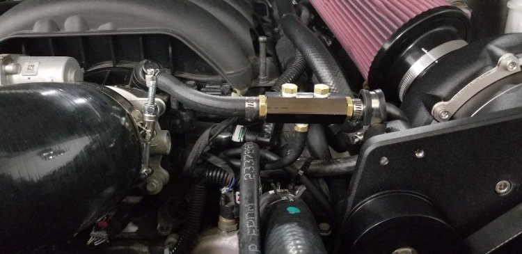

6OZ. IS OIL CAPACITY ON HEAD UNIT BUT WITH THE DRAIN LINE HOOKED TO THE LOWEST DRAIN PORT WOULDN'T THE OIL BED DOWN THE DRAIN TUBE AFTER SITTING AND GIVE DRY START CONDITIONS?20191124_185806_resized.thumb.jpg.d8212ba26ee1190c3e50e863565b5381.jpg
Yours is too clean. We would bless the oil so the drain tube is full of oil just so there isn't a air pocket trapped in it. Catch it and add it back if needed. 6568bad604ea7dbc75a9f1090b65ba64.jpg
