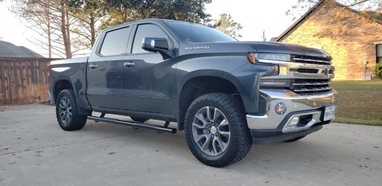

I have installed a 2” leveling kit
Looking to stay with the stock 20” rims
Question: What is the largest tire you have ran with this set up and not had any rubbing issues?

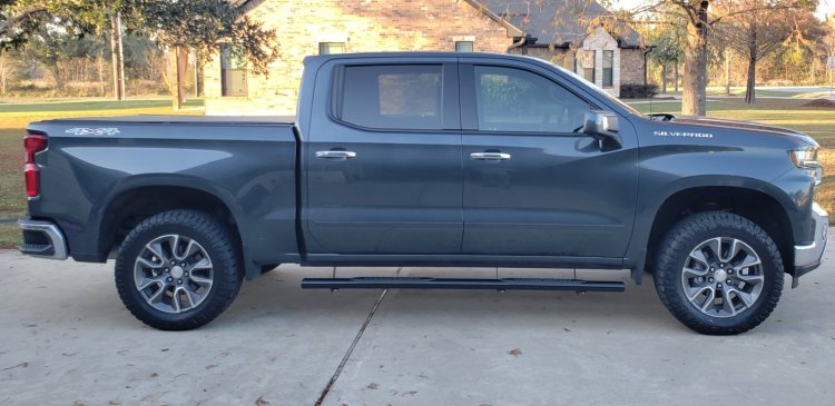

That’s 2” front level and 2” rear drop on 35/12.5 on factory 20’s. Just barely could hear the scrub on the rear of the fender mud flaps. FYI running 2” wheel spacers so probably more carpet rub without spacers

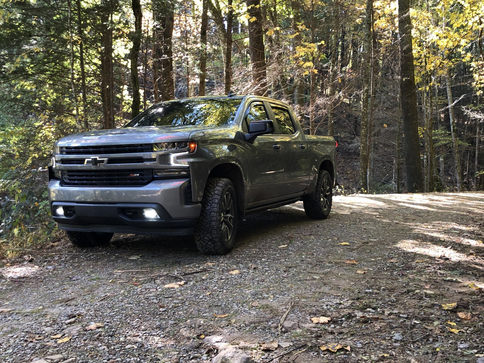

305/55r20 on mine with 2" level up front and 1.5 spacer rear.  If u do a 2" level alone you are likely gonna look squatted.  Be prepared to do the rear too.  I wish I had done a full 2" rear.
The 305s are only about .25" taller than stock.  The extra inch of width is what makes them look cool.  Looks just mean enough without going extreme and losing power and mpg.
These almost hit the UCA but dont.  No other rubbing at all.  I originally thought I probably should get a .25" spacer but so far so good.
