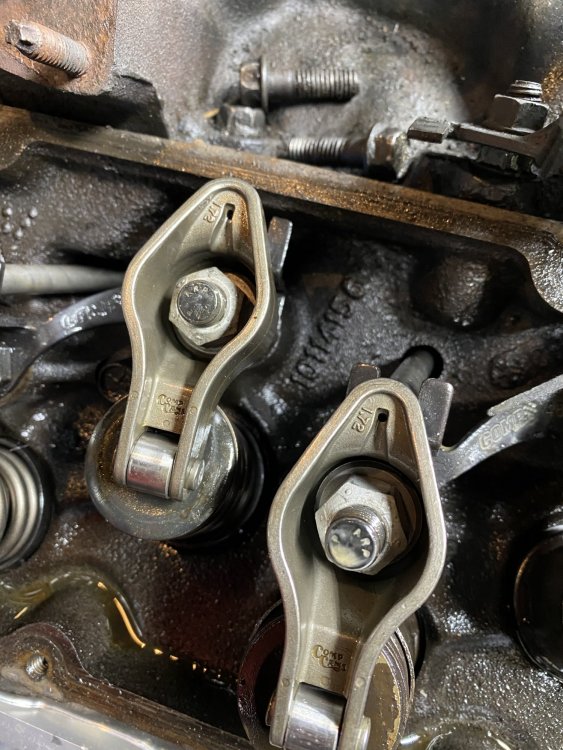

But I think I have some valve issues. I took of the factory rocker arms to swap to roller rockers. Well the factory rocker arms are non adjustable, just put the bolt through the rocker arm and tighten down to torque spec.
Well since I have done the swap I either have too much or not enough torqued down. I know I can’t torque them down like the factory or the valves will hang open. So right now, I took it down the road for a test drive and started hearing loose rocker arms again. These rocker arms are on a stud with a pivot ball and a nut, that’s it. So how do I tighten these down?
Post up a picture if you can. It's good that they are on a ball and stud as the TBI engines had a rocker arm with guides on the valve end. Prior year sbc rockers will fall off the valves without a guide.

Looks nice and sounds right. The valves look to work as they have the guides to keep them in place. Should give you a nice seet of the pants feel.
Thanks. I am having some issues with the valves on the drivers side. The factory rocker arms are not roller. Just a straight up stamped steel rocker and they are non-adjustable. Just a bolt that runs straight through and torqued down to 30 ft lb.
Well, the ones I have now (I guess you could say are adjustable), so I don’t know what the lash is supposed to be set. I do the up and down motion then a 1/4 turn after but it’s still off. Should I use a feeler gauge or just go back to stock rocker arms?

The lifters have to be off the cam lobes,so rotate engine by hand,and one thing to keep in mind,count threads that are exposed above nut,they all should be pretty close

Can also turn it down till it stops ticking while running and backbit off a flat. Works well for getting the adjustment right.
