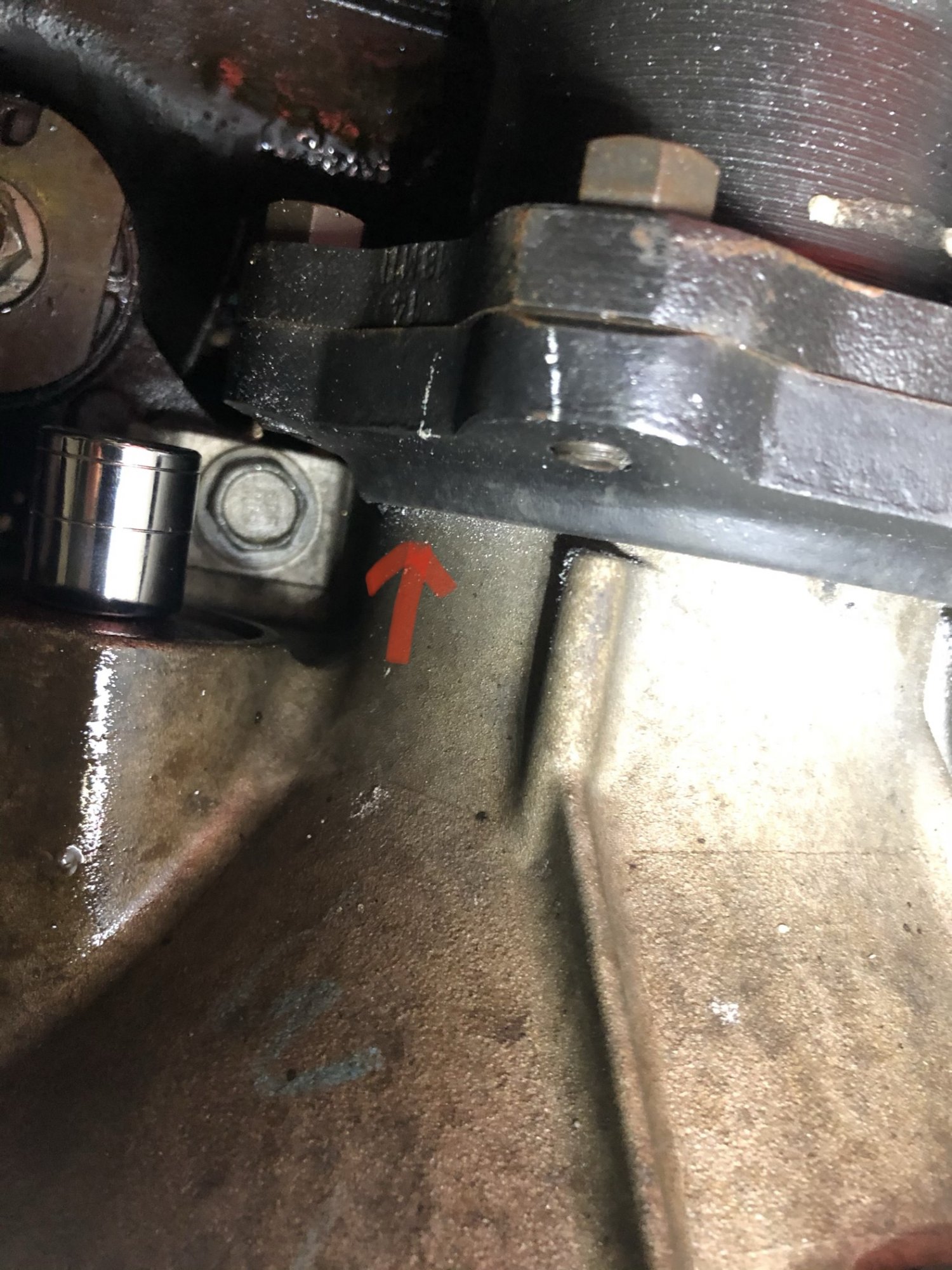

I had to leave town and had no time to get under the truck. Tonight I finally found time to hop under the truck and see what was up.  I removed the belly pan and for sure I saw differential fluid all over the driver side. I pulled the top plug from the differential and could smell a horrible burnt fluid smell. I poked my finger in and sure enough it was low enough I could not feel fluid.  Pulled the lower plug and fluid came out.

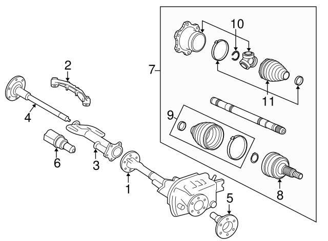

It was black and grayish/metallic from what ever was grinding. Super bummed but not sure what the damage is. I did see some metal dust between 5 and 7 in the image below.  Also, you can see the dust in the pic with the Red arrow. Which leads me to believe i blew a seal of some sort. The passenger side looks fine and has no noise or issue. AACJ 3.42. Changed Fluid about a year ago when it hit around 9X,000 miles.
My question to the forum, and I greatly appreciate any thoughts or advice.  Can I rebuild or do I replace the front differential?

Thank you for the reply. Sorry for the late response as I was out of town. I stopped by a local transmission and differential shop and the owner of the shop pretty much said the same thing based on the pics I sent him. He agreed I could do a rebuild myself.  He thinks the gears are fine but the bearings and area where the axle connects was possibly rubbing.  He said I could pull it out and bring it in to him and it would be a lot less labor to check it out. But again he said without really looking at it in person there is not much he could recommend. I like doing these projects myself and have rebuilt quite a bit of motorcycle and small car engines. Never removed or rebuilt a differential. But it does not seem to complicated.  Is there a good site that folks on this site use to order parts or rebuild kits?  I am also looking for an exploded diagram/parts list for my 3.42 front differential. Can anyone recommend one?  If I do decide to dive into this should I look to upgrade to a 3.7 gear and would that include needing to do the rear to match (Ill google more on that).  But since I have the front diff removed, should I upgrade or add anything else?  The truck is all stock and not lifted.  Thanks for all the help.
