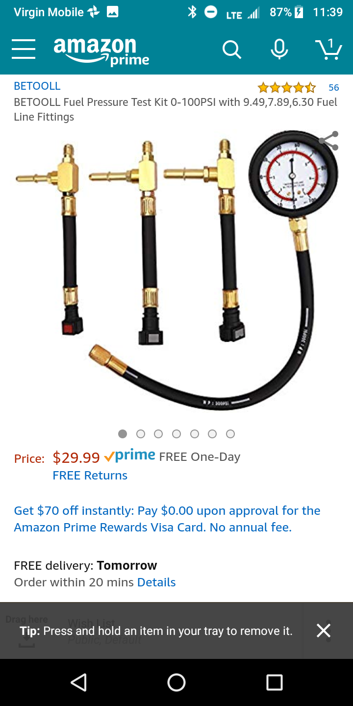

Thanks for replying. I ordered a fuel pressure test kit that someone linked me to on Amazon. I'll be sure to post my results once it's in. Picked up a scan tool too for the next time it throws a code.
Is this the correct kit I need? Picture attached.
So the best way to diagnose this is to check fuel pressure, if normal then unplug MAF and look for improvement. If no improvement move onto the exhaust/cat and disconnect and check flow?
