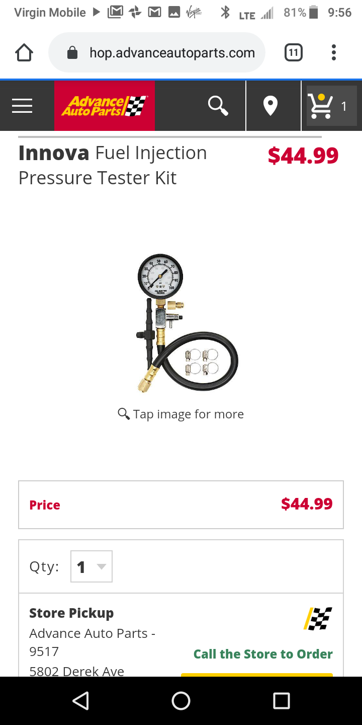

That looks like a good tester,got all the fittings for other vehicles without test port,and try to keep the cats,good for all of us,and you will get codes without them
I picked up this one locally. Will report back here with results. What should the psi be at the rails?
