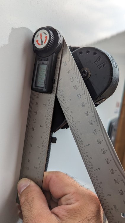

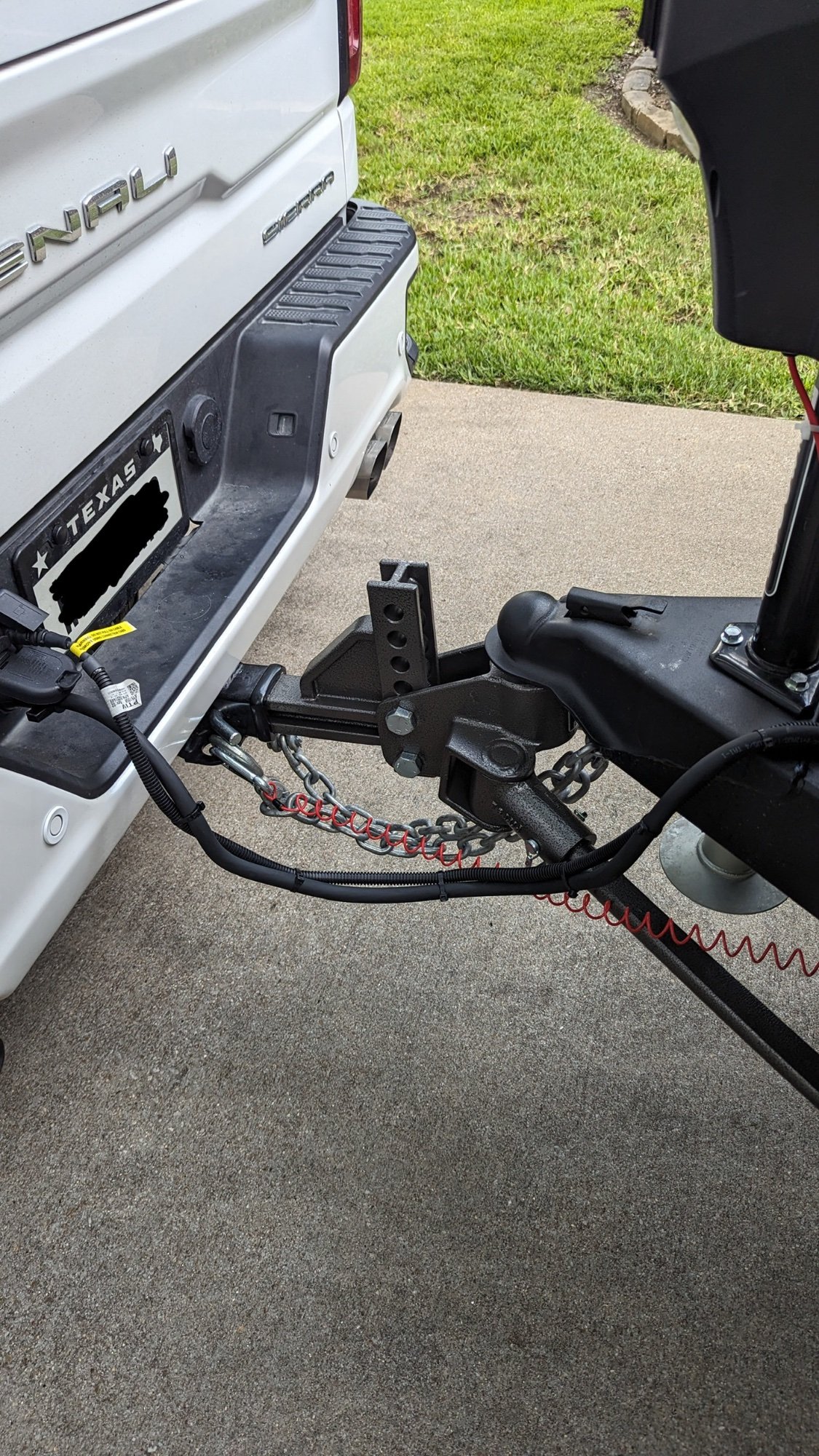

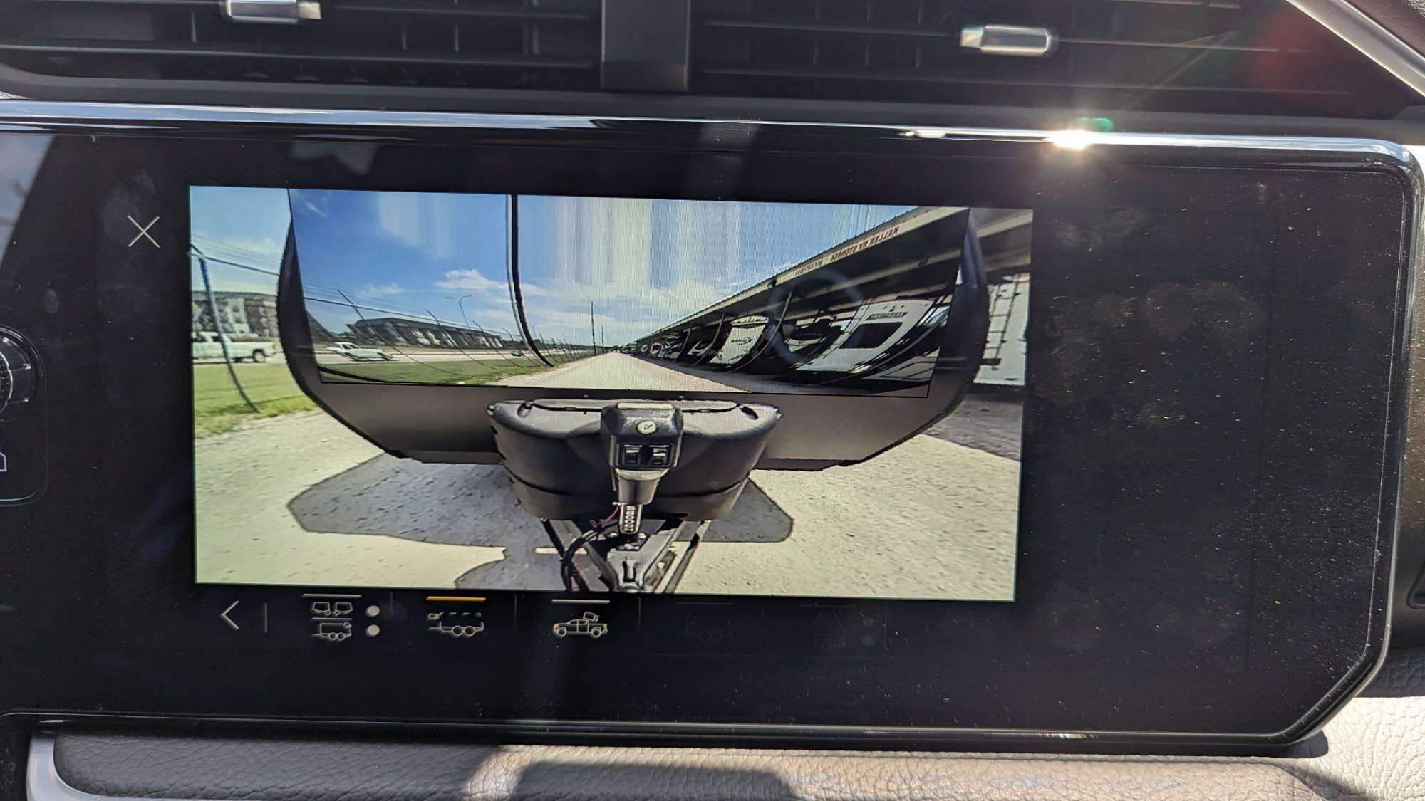

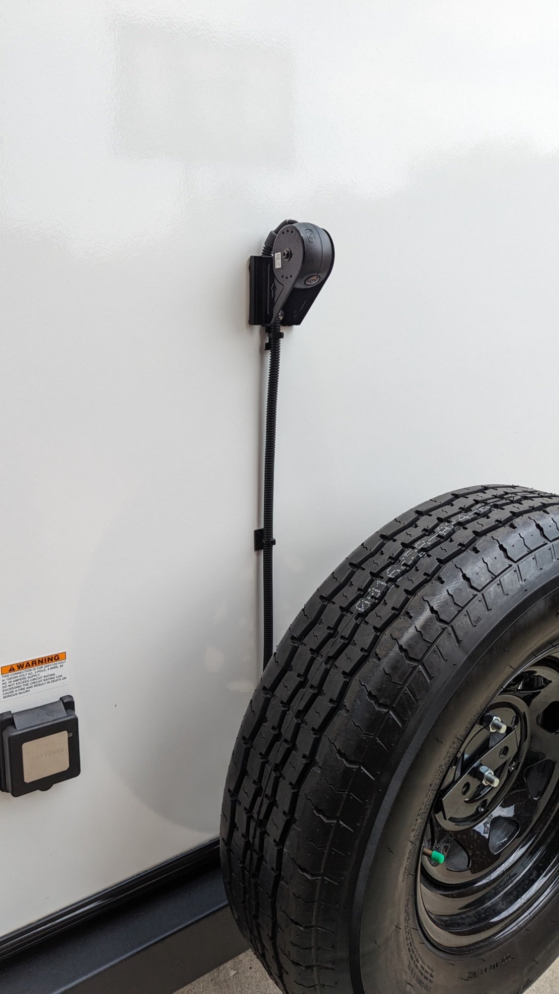

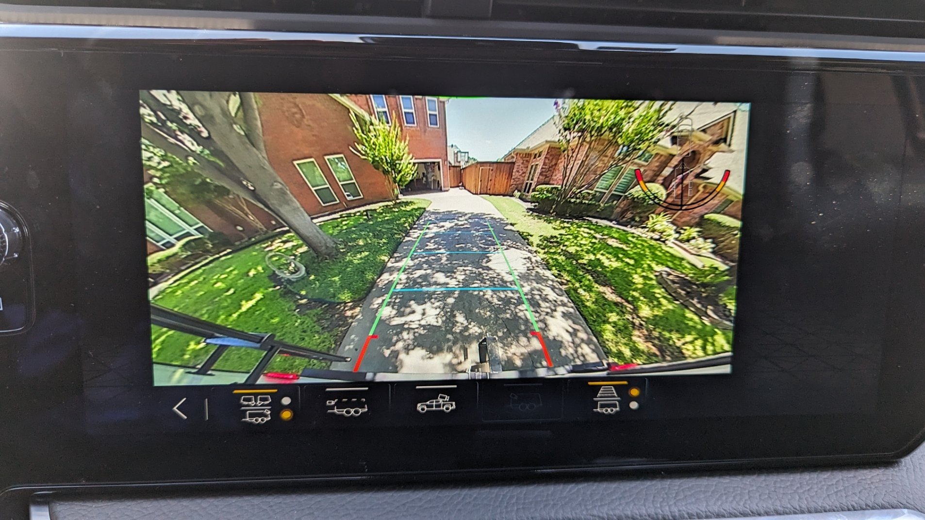

I get the “Needs to be Calibrated” screen. Drove about 20 miles, but never got the Transparent Trailer view, just the split 3 camera view and the blind spot warning when I turn on the blinker. Any ideas how to get the Calibrating to finish properly? 2023 Denali 1500 with OEM GM trailer camera.
Attached a few photos.
14 minutes ago, MTU Alum said:
My suggestion would be to remove the spare tire and try to calibrate.  I assume you are driving under 30 mph correct?
Yes, I drove 25 mph but never saw a progress bar under Invisible Trailer view in Camera APP. I’ll remove the spare tire and see if that helps. If it works, can I return the spare, or should I use the time to relocate it somewhere else?
You can reinstall after calibration.  If you still have problems, you may want to change one dimension by an inch.  It sometimes doesn't like shadows, so may need to drive in opposite direction if you see a large shadow.  I hope this helps.
