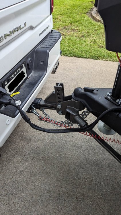

Hi Wayne
I have an Airstream FC30 with a ProPride hitch.  Here are the measurements I'm using.  It took longer than I expected to complete the calibration, but it's working for me now.
