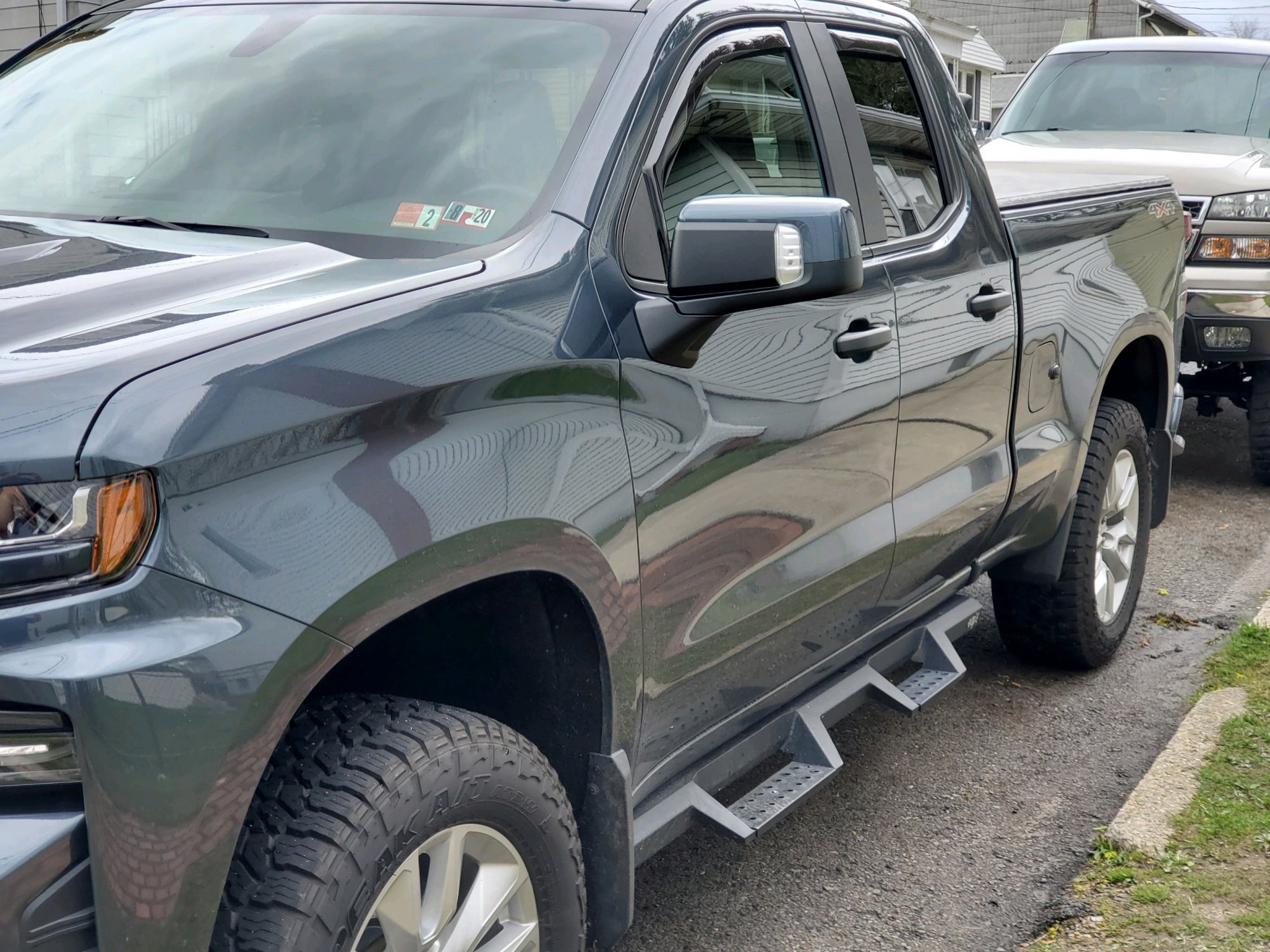

Going to do a test in a day or so, I picked up a set of mirrors with task lighting pretty cheap. I got the light switch too for it too, I'm wondering is the wiring there for it....it's a cross my fingers deal.  Would be nice since I have the power tailgate, bed lights, tailgate light etc.
I did the led lt headlight and grill upgrade and ll od that works perfect. The drl goes out with the turn signal too.

These aren't power folding, sorry.   These are just self dimming, task light and blind spot.  The power and self dimming work, task lights even with the switch do not. Looking into that tho, not sure if they can be turned on in the bcm or do I need a harness.  As for the blind spot there's alot to that so that's out..lol.
I was so glad to get the scratched mirror and the drivers stock mirror has that little mirror in the corner. I hated it..lol
I figured out how to make the lights work in the mirrors, they can be turn signal or come on when you unlock it.  Between the doors there's a cap. It has a bunch of terminals in that spot.  I'd imagine it would be better when you unlock or use the cab light.  Thinking about it, its not going to be easy to make the light color match the led turn signals.
