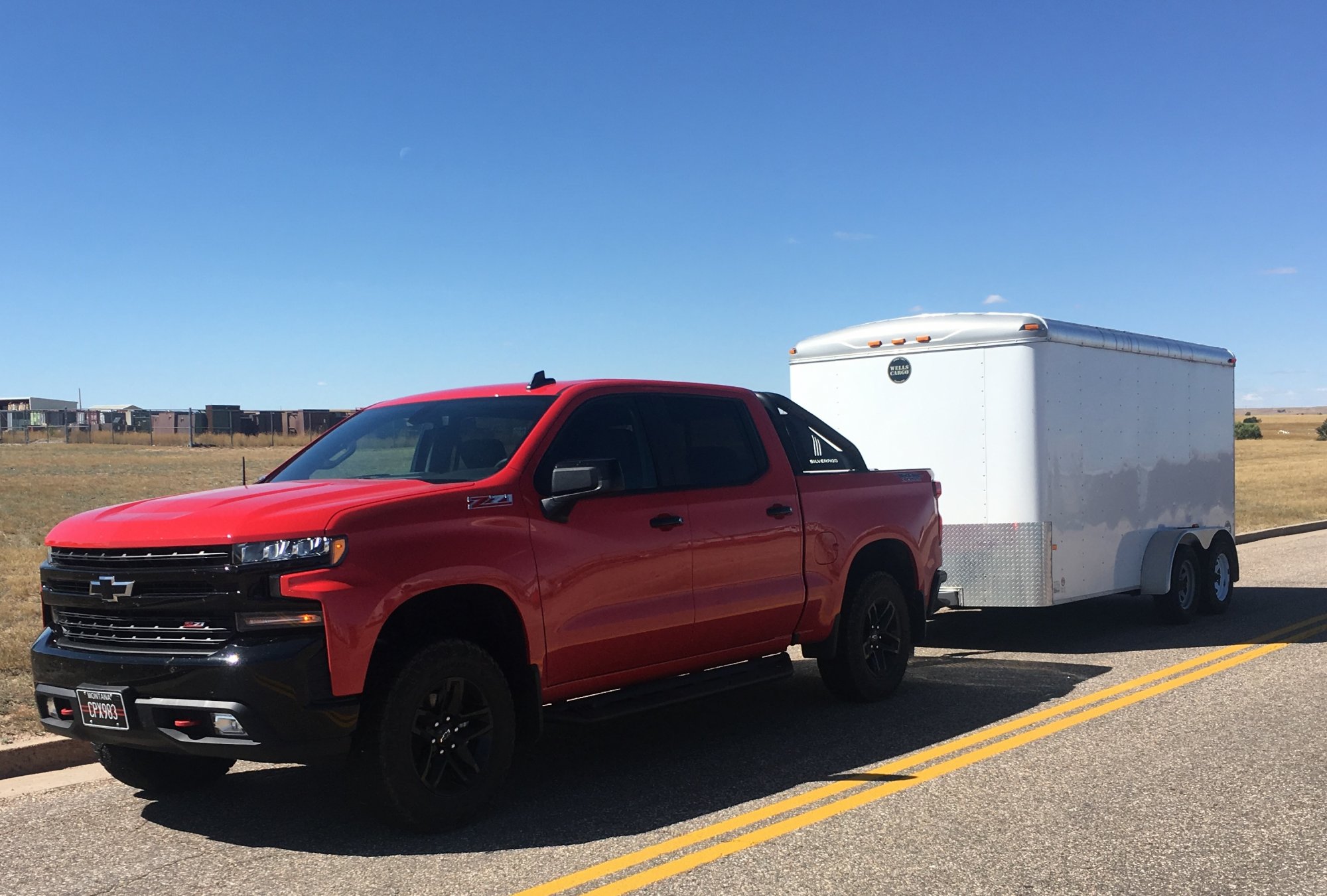

I tow a 5000 lb (loaded) cargo trailer a few times a year with my 2019 TB and it does great!  I did swap out the tires for slightly less aggressive 33" BF Goodrich KO2's.  Only the 5.3  w/ 8-speed was available that year, but I believe the 6.2/10-speed would do even better.  My truck also has the Advanced Trailering Package which makes towing nicer, but is not essential.  FYI, the diesel is not available in the TB.
