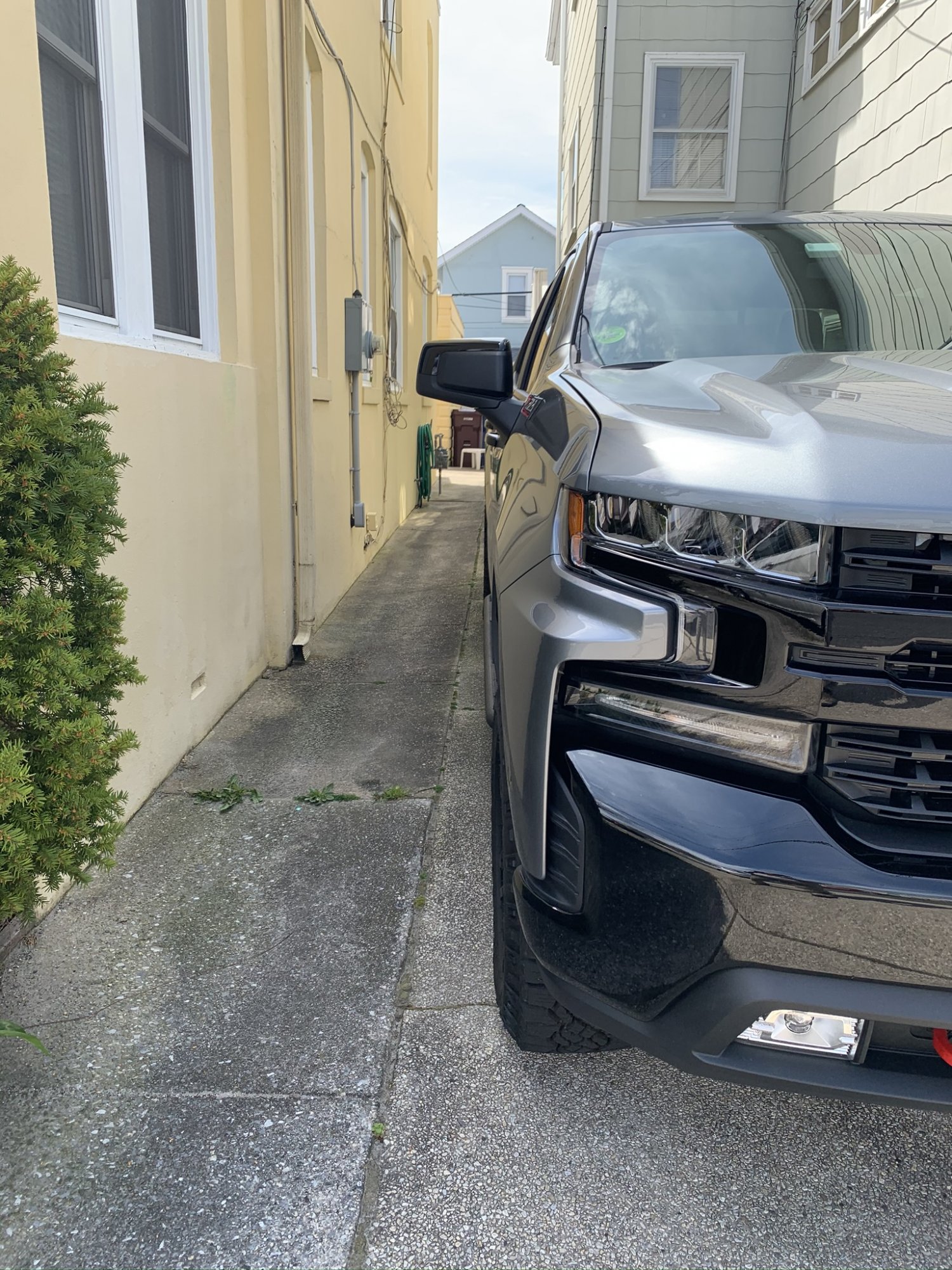

Put 2” Rough Country wheel spacers on. Just the right amount of ‘poke’ from the wheel wells. Love the new stance!

Running stock Trail Boss tires. 275/65/18. No rub whatsoever. Are your tires aftermarket?
