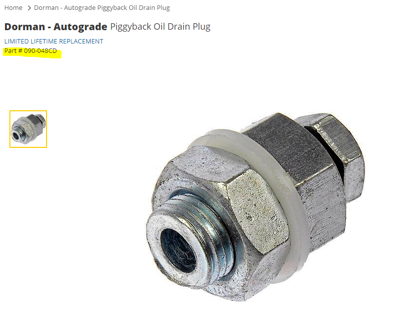

1 hour ago, JESTERX888 said:
$6.00 for this. No welding required.
Yeah until it looses itself up and the only way to fix it is to take the pan off again
