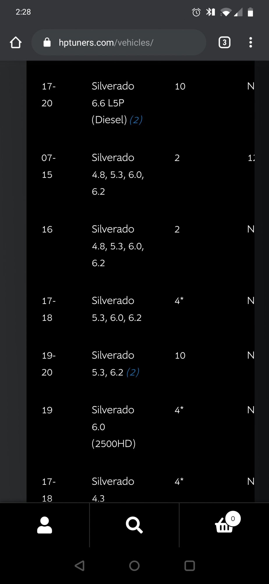

Hptuners can tune the T1s 5.3/6.2 engines but it's pricey and no trans tunning yet
You have to send them your ECM to be physically modified or purchase an ECM from them that has been physically modified.
Just a bit out of my comfort zone for 30HP.
