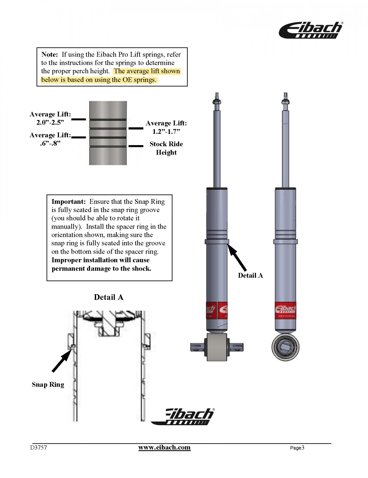

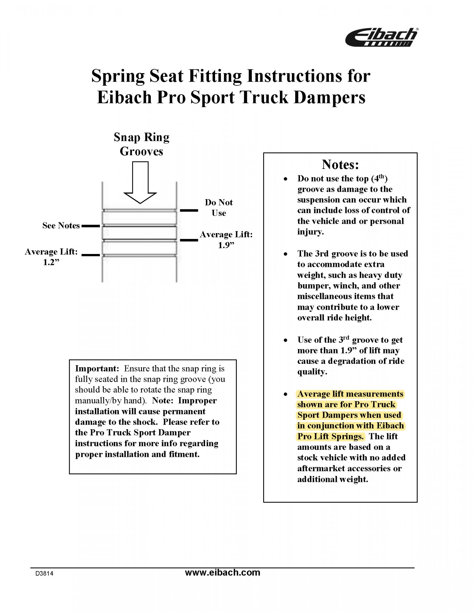

The Eibachs have arrived (almost 2 weeks), but I'm still waiting on the RC 2" rear blocks and bolts which should be here Friday.  I'll document the install and post photos after I complete the install this coming weekend.  I know quite a few people have questioned the actual install height with the shocks, vs springs, vs shocks and springs combo, so I'll photograph the install sheet that has those dimensions soon and post them here as well.
Here are the approximated lift heights for the Eibach system when used with Eibach springs vs OE springs.  Please read the highlighted area to distinguish the two documents.

jeez, lol.... its says so right in instructions.....you know many dudes started threads arguing that you only get 1.2 of lift with or without std springs  even though members who actually installed kit and told them the amt of lift they got....but it conflicted with the way they read the instructions.....and they just couldn't wrap their head around it, lol
too funny
the trippy thing is Eibach doesn't seem to mind you using all of clips with OEM spring but shy away from top 2 with their spring....or at least the top clip for sure and give notes on second one down
good info for those going forward
 if I was keeping mine this is kit I would get for sure, plus they are 20 min down the fwy

I went with icon front coil overs because I wanted more than 1.9 with their springs or 2-2.5 with stock springs. I’ll get it set at 2.5” and throw a 2.25” block with fabtechs stealth shocks. Won’t hurt the ride like setting Eibach’s at the top will. I’ll be picking it up Thursday. Btw I understood the Instructions, I got hung up on Eibach’s website filters. It’s effed up. I even called and they never responded with why their website is retarded. Anyways, it looks like a solid kit, I just wanted more than 2” for it to be worth it. Let us know when it’s all done

Im over 1.9” with the Eibach springs/struts on 3rd clip, just saying.
How is the handling on the 3rd clip?
Amazing. No more nose dive when braking, much more planted in the corners, and the bounce is gone. The ride is firmer then stock but I don’t mind it.
That's the kind of information that t I'm looking for, but I was hesitant to go to the third notch because I haven't heard the side affects of doing so from anybody.  Compared to my F250, this truck rolls, sways, dives, and bounces way to much for my liking and I wanted a much more planted feel.  Thanks for the information!
