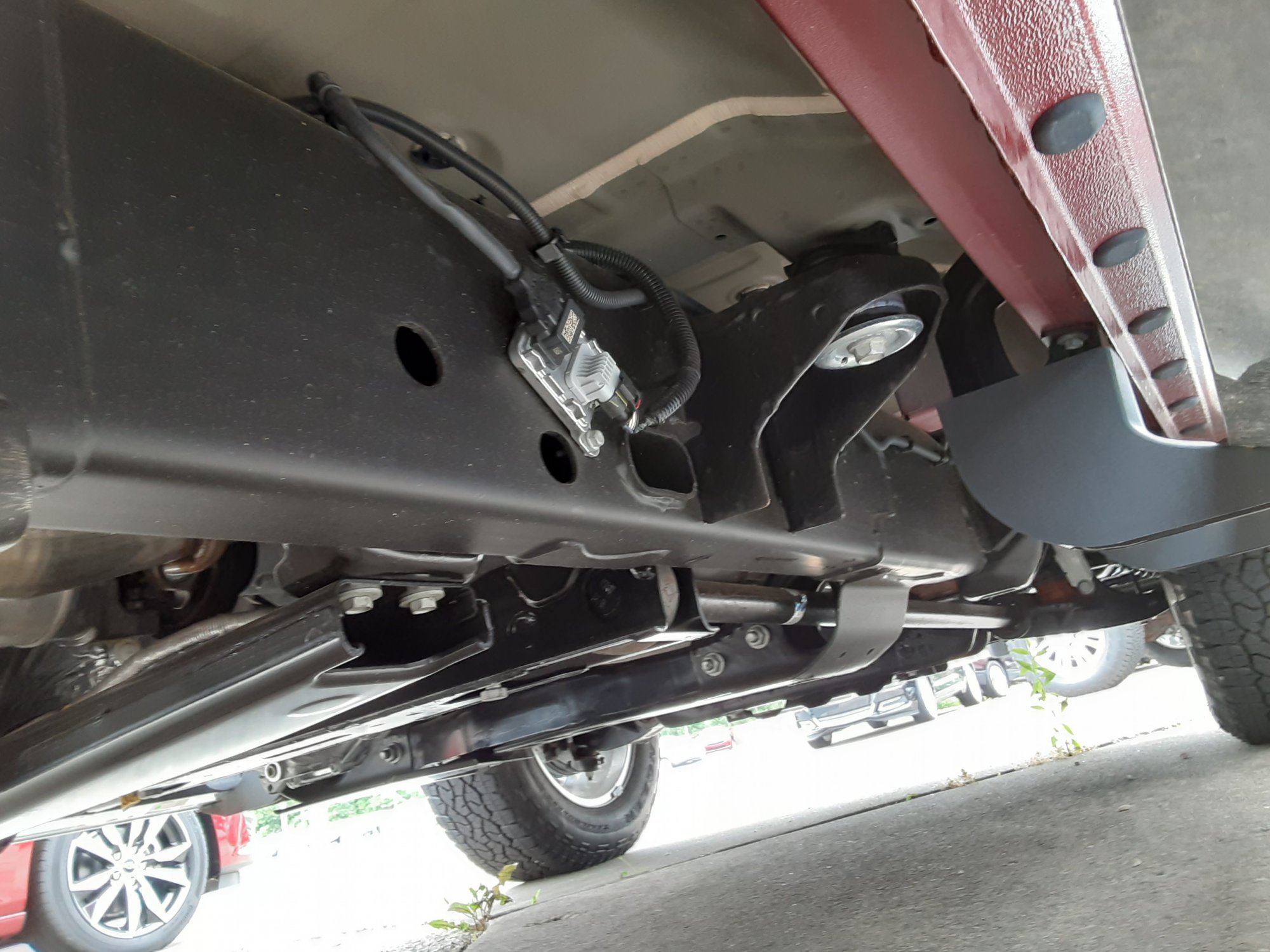

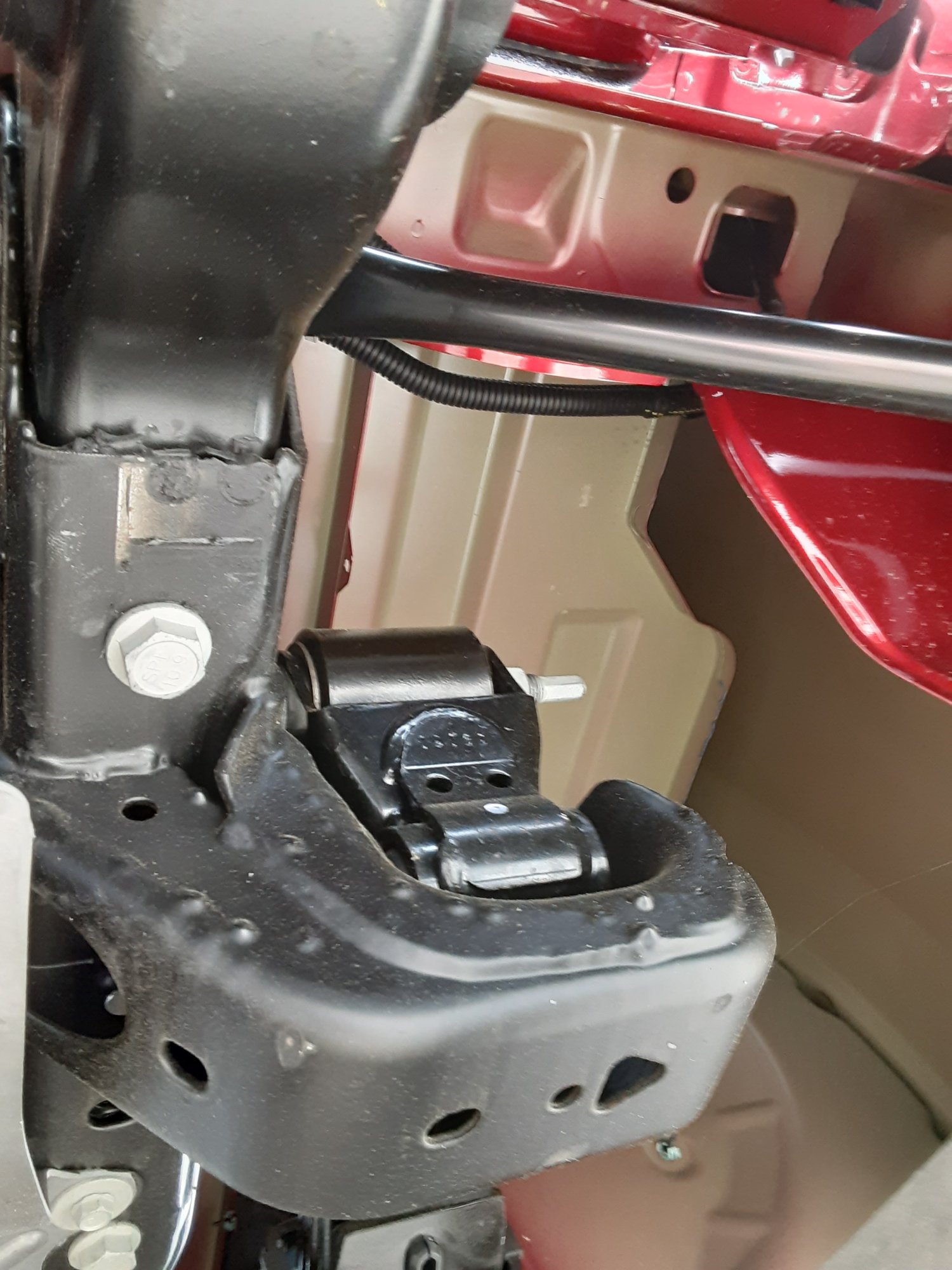

Small up-date. GM customer care is still playing games, nothing less than I would expect. I made an appointment at now the third stealership and same BS as the last one. Everything is normal, we just gave out out last rental car so you can wait several hours (service manger actually said all day) or better yet take it to the dealer you bought it at. Okay i get it they have enough customers and don;t want my business. They should quit their I didn't buy it there crying, because I paid cash and they wouldn't make any money on the financing anyway. Invoice was 57 and I paid 60. Service is where these idiots make their money anyway.
Sorry, less i digress, I was thrown off the lot when the service manager said all the new cars on their lot are severely rusted as well. So I simply said lets throw one of your High Country's from the lot on the lift next to my truck and compare.  When I called his BS lie he freaked out and told me to take my death trap somewhere else. He did not know what to do when I called him on his lie. Although none of this is funny I was laughing at his embarrassment. He was not able to see that because I was wearing a mask, I could see he was not laughing because he and several other employees there did not have their mask on covering their mouth and nose. They just had them around their necks. Maybe they had trachs, but shouldn't they wear a bigger mask to cover it all? Then I had to ask to get the damn thing sanitized, those stupid commercials are garbage, after asking to get it done two dirty looking idiots got in the truck with no gloves or masks on, touched everything and sprayed what looked like windex on the leather seats,  When is GM gonna run in their adds, "all of are new cars are severely rusted on the lot". "It's normal to expect severe rust on the frame of a new truck". I could respect that so then I know what I am buying, I have to admit though I would not pay anywhere near this amount for a rust bucket.
I was able to get under one of the High Country's on their lot and take some pictures, before i was asked to leave.
You tell me if I am out of line here?
1 hour ago, Tahoe Tuff said:
Now you can see why he threw me off the lot.
The taking pictures isnt why you got thrown off the property but I can sure see why based on the more posts you make....
