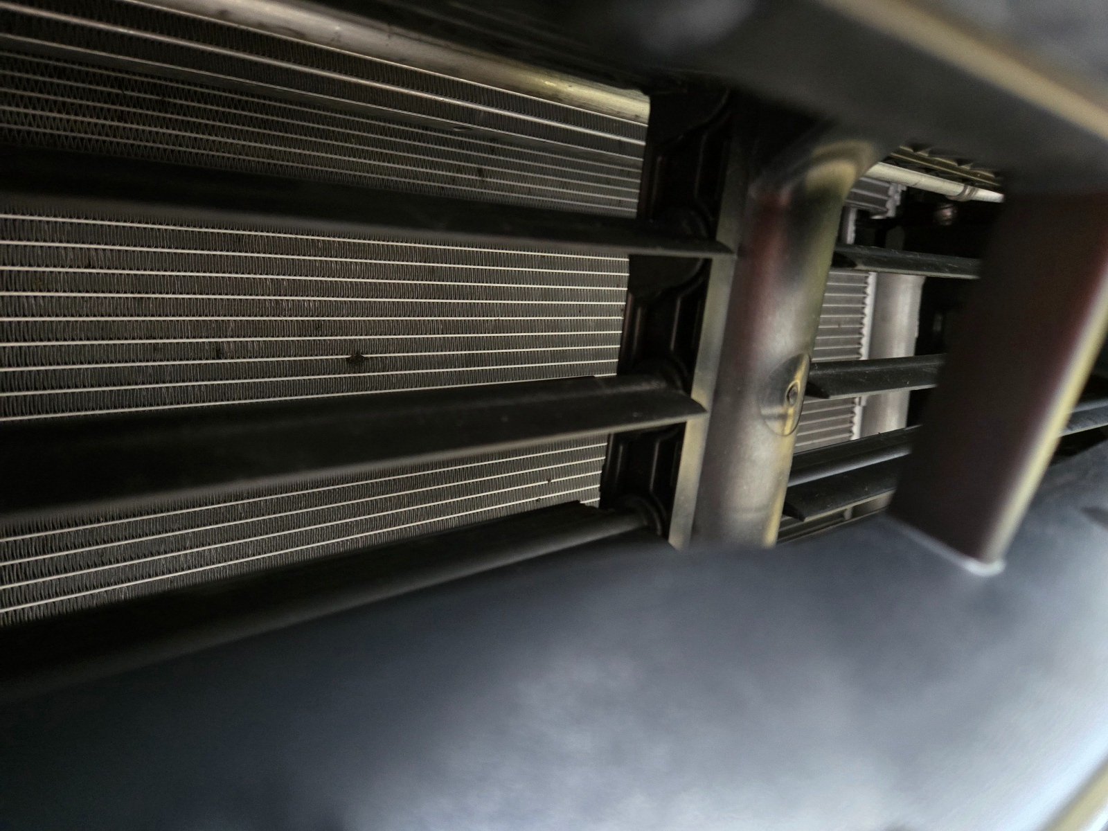

I just looked at my build sheet.  I do have WMI listed as reflected in the screen snip below labeled as "SALES PACKAGE - CONV PACKAGE."  I do not have shutters.
WMI is shutters.
  • Thanks 1
Here is a photo through my front grill.  I assume this is consistent with my truck not having shutters despite having the WMI build code??
1 hour ago, newdude said:
I'd double check your build sheet.
Ran some 2021 2500hd Duramax VINs without plow prep and they all had shutters in the build.
I also checked the 2021 MY production option changes, WMI shutters were never deleted/removed during the production run due to any current events.
I don't have my build sheet, so I dug out my window sticker and it indeed has the snow plow prep/camper package listed. So you are right, I'm just an idiot and overlooked/forgot it was on there.
I lookup and keep a spreadsheet of all the RPO codes of my vehicles I own and that's what I was referencing to see if I had the snow plow package. My truck does not have the "VYU - PROVISIONS-SNOW PLOW PREP" or the "WMI - SHUTTERS-FRONT GRILLE, ACTIVE, UPR AND LWR" RPO codes which is why I was mistaken.
I wanted to provide an update to my saga.  I have tried a few times to take a look to determine whether I have shutters on my 2021 Denali SRW Denali 3500 Duramax.  I have previously only looked in the light of day and the view of radiator fins was prominent.  Tonight, I took a closer look using a bright LED flashlight  after dark.  The view was much better and I was able to confirm that I do indeed have shutters. Really a big shout-out to newdude who provided excellent assistance through his posts and some private emails!
