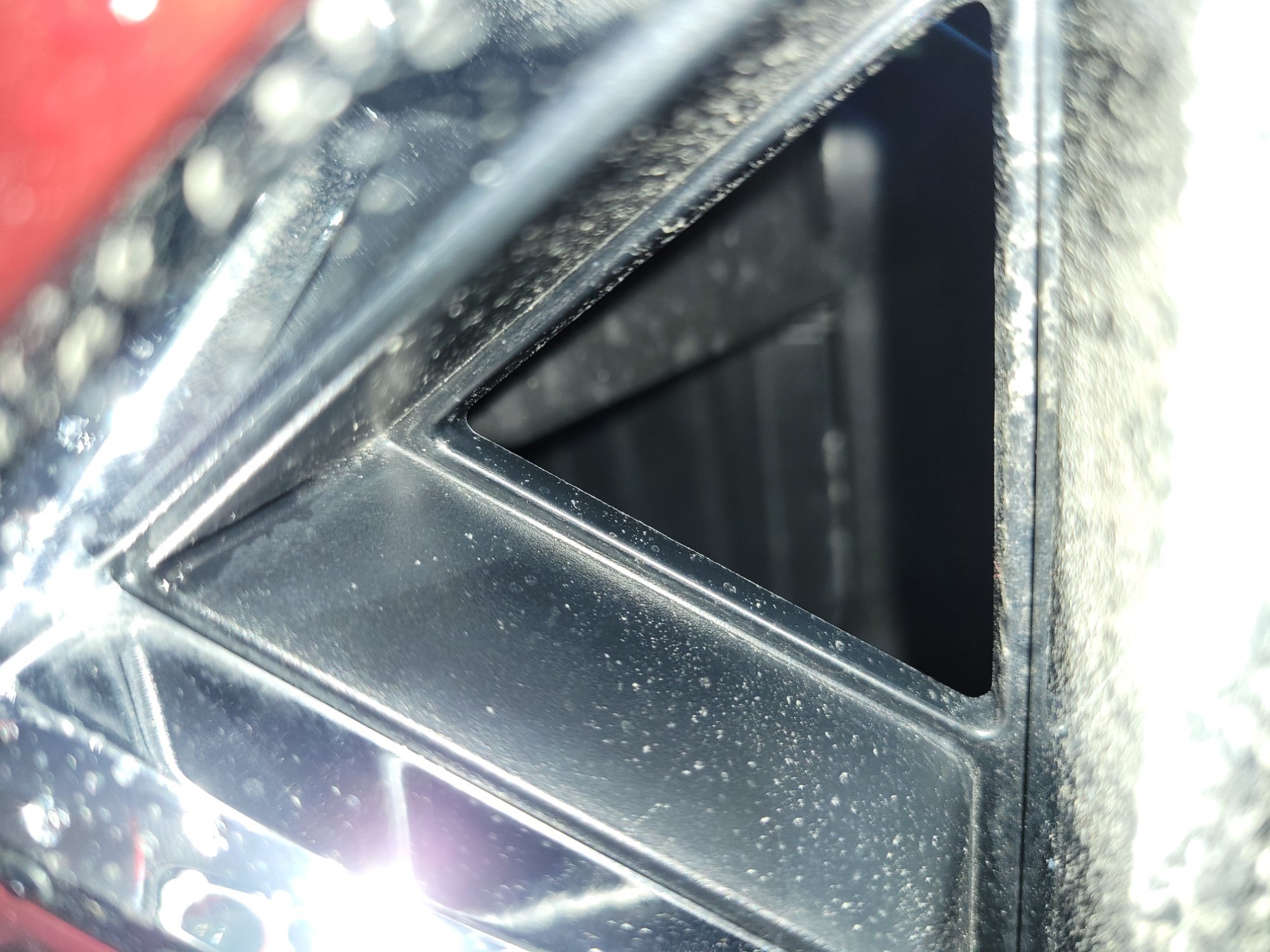

What is the code or designation for shutters on a build sheet?  I have a build sheet for my 2021 Denali 3500 SRW Duramax and do not see anything that mentions shutters.
WMI.  If you have VYU you won't have WMI.
Edited by newdude
I just looked at my build sheet.  I do have WMI listed as reflected in the screen snip below labeled as "SALES PACKAGE - CONV PACKAGE."  I do not have shutters.
