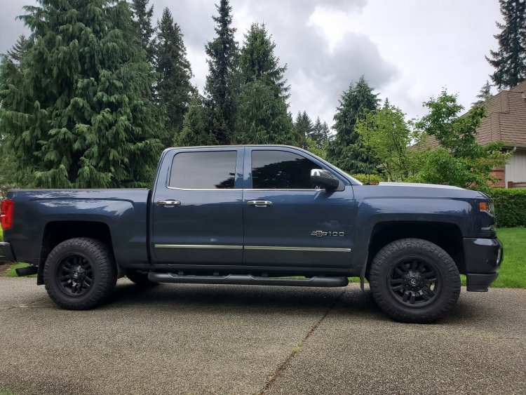

I added a ReadyLift 2.25" REAR BLOCK KIT as well as the Fox shocks front and back. It sits about 1" higher in back, but I carry a lot of gear regularly, so it is often level.
Beautiful truck! Love the Centennial blue with the black Sludges. What’s your wheel and tire size?
Fuel Sledge 18x9 +1 (Thread Size: M14 x 1.5, 6x5.5(139.7) Bolt Pattern)
Tires:
1st attempt (rub in reverse and full lock): 295/70r18 Nitto Ridge  (34.3 x 11.6)
Now (no rub): 275/70 r18 Nitto Ridge (33.2 x 10.8)
Want 285/70/18 (out of stock a few years ago)
I might move back to Duratrac from Goodyear though. I love the look and low road noise of the Nittos, but their winter snow, ice, and slush perf was fairly poor.
My measures from ground to fender are 39 in front and 40 in rear.
PS: thanks for the compliment too ?
Tires:
Now on your first attempt was it rubbing on the liner or what exactly? I’m looking to push it on mine lol as close to 35’s as I can ?
I hear you. Fortunately for me I live in the high heat desert and have never seen snow fall. You should look into Goodyear ultra terrain AT’s. I’ve seen a guy on YouTube who swears by them.
Rubbed the mud flaps for sure, plus front liner. Even with trimming, it still rubbed. Not enough to be undrivable, but noticeable. A little tread wear I think would have solved it.  But I chickened out when someone said it looked like a double stuff Oreo
