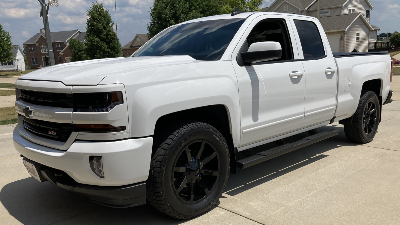

UPDATE #2
I decided I was going to try the 33s one more time with plastic trimming, successfully pulled it off! Very very minor rub on fender liner at full lock. I don't 4 wheel other than a occasional camp road and every where else I drive this setup will be fine. So these are 33x12.50x20 Atturo Trail Blades on a 20x10 -24 MotoMetal 970.55ce3e452b3b69fd6bafa7e95ed63f75.jpgd9ee7b19a027ab222ba0aa21f76d3e06.jpge3a9759cb159f5ca30b559a623e8eb67.jpg
