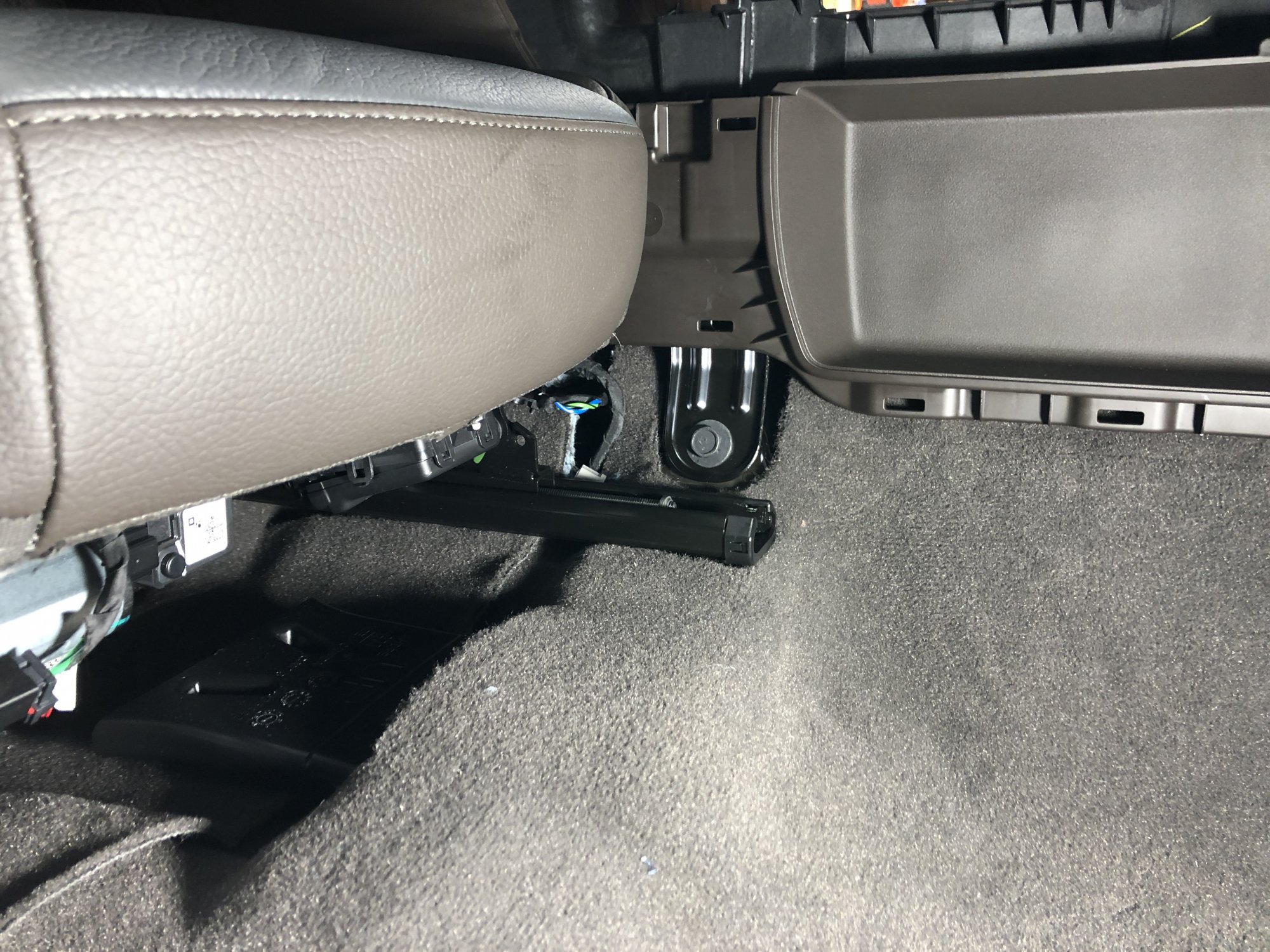

I have a 2020 w/ Bose and was able to locate and access the sub speaker wire beneath the center console without removing the console or any seats. I haven’t seen anyone post on this method yet so here it is.
Remove the plastic side panel from the center console on the passenger side. Think it was held on by several panel clips.
Slide the passenger seat all the way back to expose a carpet seam at the bottom of the console. Pull the carpet flap and peer under the console towards the rear of the vehicle with a flashlight. You should see a thin harness wrapped in black tape anchored to the floor with zip ties.  There are only two wires in the tape.
You should be able to get a hand or panel tool in there to wiggle the anchors loose from a threaded stud or bolt.
There wasn’t much slack in the harness but try to pull as much out as you can. Carefully snip the black fabric tape exposing a green and a blue wire. I can’t remember which wire was positive or negative.  You will probably have to research wiring diagrams or someone may recall.
I scored and slid the wire insulation to the side exposing the copper wire and then soldered speaker wire to it. Sealed it and taped it back up and put it all back together.
Ran the speaker wire under the passenger seat rails inside a seam in the carpet to the passenger door sill. Then ran it inside the factory wiring track along the passenger side under the door sills to the rear seat where my LOC is located.
This may be difficult to follow so here are a couple images. I hope this helps out the installers out there.
I did not have to bypass the ANC for my minimal setup with just a small single 10” sub supplementing the existing oem sub.  I don’t believe ANC is canceling any of my audio output and likely determines my sub’s output as music instead of noise.
I did not need a remote turn on signal for my amp because it already has built-in auto power on sensing the audio signal coming from the Bose sub speaker I tapped into.
