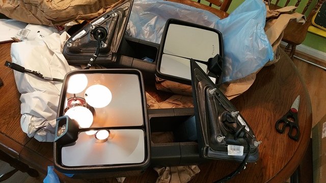

Does anyone know the part number for OEM power folding mirrors. I keep finding kit 23372182 which includes both oem tow mirrors but I cant find the kit with the power folding. Im trying to go oem because I've already got some aftermarket ones on it that are garbage.
Try these part numbers...# 23241467 & # 2324146520150506_120922.thumb.jpg.ff342a1b978b3fe5ae8c3fd4ea104e99.jpg

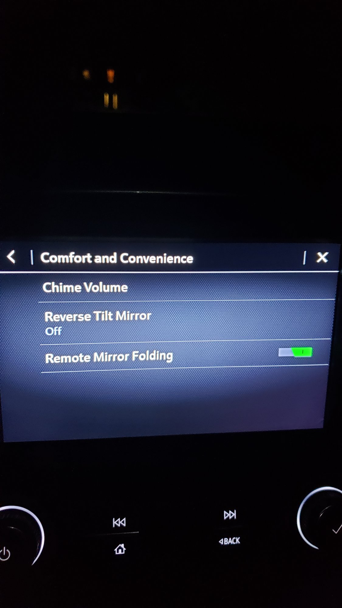

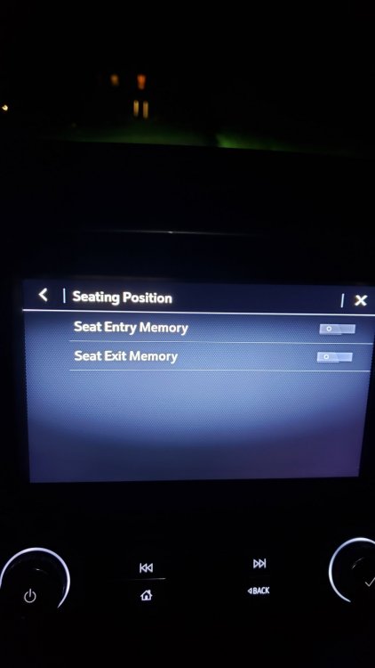

I got power fold mirrors and memory seats working today.
I have a loaded RST Silverado but power fold/memory was not an option on RST.   My body harness had all the wires and pin layout for this to work.  I did not have to rewire anything.  I only had to replace harnessess/switches and a window regulator.  I also did not program the memory module.  I bought power fold mirrors a few months ago when I added 360 camera to the truck(see my post on this) so I thought I would try adding power fold/memory and cooled seats.  Cooled seats do not work yet that will need BCM programming.
At first I had everything connected and it didn't work.  This was depressing, then I put down windows and everything started working.
Key fobs folds mirrors in and out.  Driver switch works folding/adjusting mirrors/windows.  Mirrors point down in reverse (when I turn that option on).  I can use fob to put windows down(when I turn option on).  All memory functions work.  Seats vibrate with cross traffic alert(when I turn option on).  All the options to show up in my radio.  Passenger power seat works.  The only thing I don't think works is there are no pop up messages on my speedometer like if I am driver 1 or 2 with memory seats.  I also don't know if puddle lights work yet.  I will find out when it gets dark.
