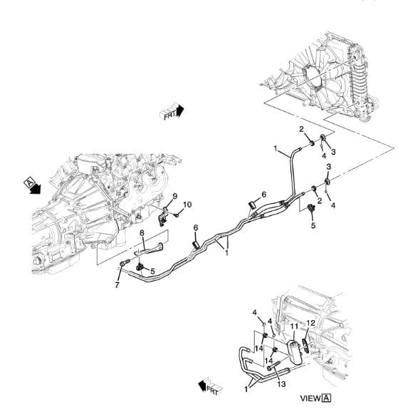

13 hours ago, newdude said:
Gonna pop them in here for everyone's reference.  6 speed only just to keep things simple.
2014-2018 4.3 V6/6L80:  Transmission cooler in right radiator tank, lines flow from transmission to cooler, cooler to transmission.  V6 are equipped with the TBV.
2014-early 2016 5.3/6L80 and 2014-2015 6.2/6L80 (yes, these exist):  2014-early 2016 transmission cooler setup had a cooler in the left tank of the radiator, and then the aux cooler is a part of the condenser assembly aka the Combi-Cooler.
Flow would be transmission to the left lower inlet at the left radiator tank cooler, out of the top to the aux cooler (via pipe #14 below), then aux back to the transmission (via pipe #5 below).  Equipped with TBV.
If the TBV is "flipped" or SureCool, these year trucks, the transmission cooling loop would operate like all the 2013 and prior 1500s where the flow was constant all the time as they had no TBV.
Late 2016-2019 5.3/6L80 "Limited/LD" (still K2XX platform):  GM ditched the transmission cooler in the left tank of the radiator.  The aux cooler on the condenser (the Combi-Cooler) is now the ONLY cooler brick for the transmission.
Equipped with TBV.  I'm 99% sure flow is transmission to the left side of the cooler (via pipe #15 below) and then from the cooler back to the transmission (via pipe #6 below).
Side note on these trucks.  When bypassed (flip or SureCool) these ones actually keep pretty cool.  When I had mine, on a hot summer day making WOT pulls I struggled to see over 165F.  Winter time however, it keeps TOO cool and would actually LOSE temperature.  It'd get to like 105-110F and when cruising at highway speeds it would drop to 95-99F.  Shifts feeel like a transmission right after a cold start.  I installed the GM lower temp TBV and it drastically improved temps for the winter and improved shifts.
Question @newdude. Rock Auto list radiator GM part #21902 as the unit used for the 4.3 V6 with NHT. A bit thicker. 1.1" instead of the non-NHT 7/8". You didn't speak to the NHT V6. Can you confirm this RPO and part# and line routing? PLEASE 🤩
More Information for GM GENUINE 21902 (rockauto.com)
There wasn't an NHT option for V6.  NHT max trailer was only 5.3 and 6.2 for the K2 pickups.
That 21902 wouldn't work because the transmission cooler will flow on the left side of the radiator, engine oil on the right side.  The V6 radiators have engine oil on the left and transmission on the right.  Radiator 84186716/21895 is the only radiator that fits the V6.
