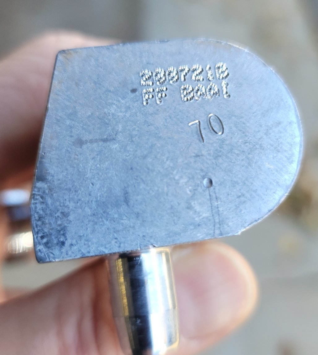

4 hours ago, 14burrito said:
So you kind of have two options now.
1. Pull flip
2. Check your new t-stat housing, if its stamped with a "70" it has a new lower temp 135 stat installed vs the original 180.
21-NA-199 will provide more details. You might be able to get the dealer to cover the cost of a new tstat assembly if you provide them that TB.
Thermostat part number is 13511136 which shows to have maybe been replaced by 86774933.
Not ALL of the new transmission thermostat housings have the stamp on the outside of the aluminum which complicates things further.

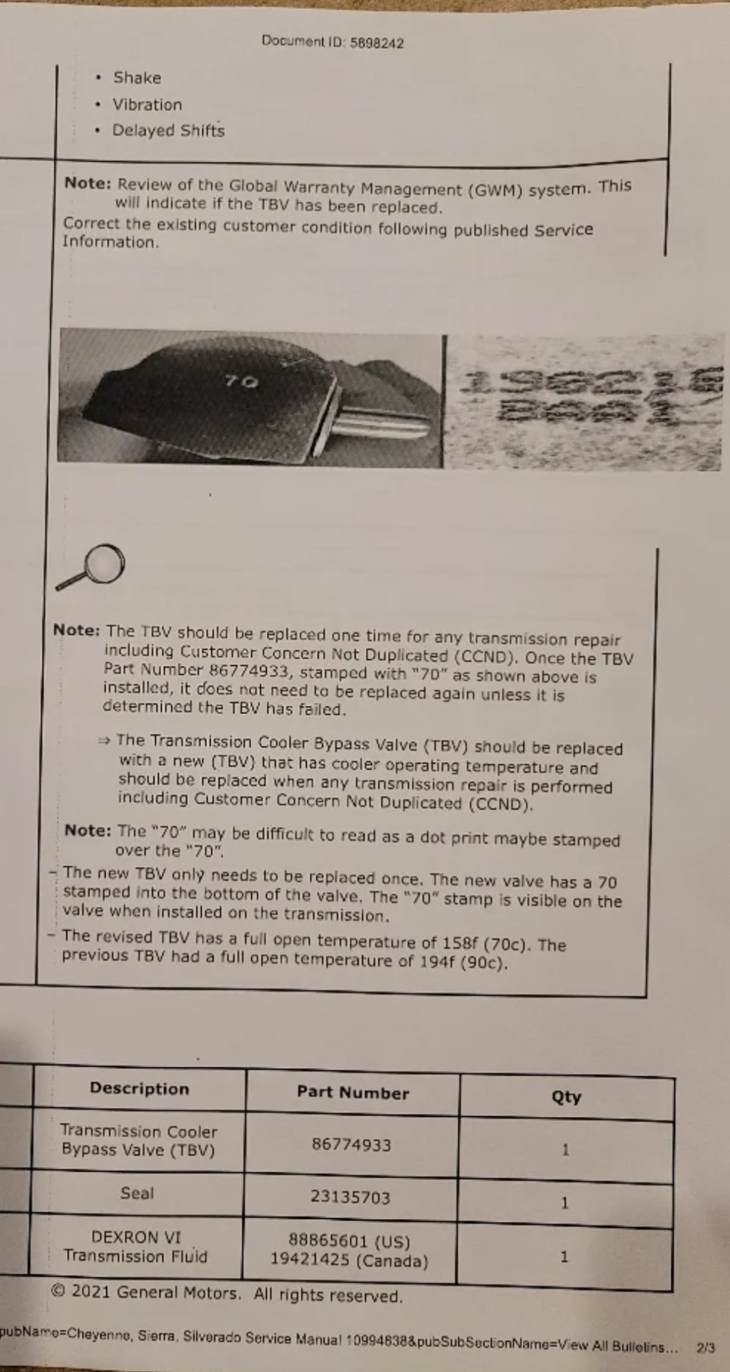

1 hour ago, mikeyk101 said:
Taken from information in the bulletin:
"The new TBV can be identified by the “70” stamped into the bottom of the valve"
Unless a new trans thermostat was installed within the last month or so by dealer, it won't be part #86774933 and won't be stamped with the 70. I imagine the reason for stamping the new housing with the identifiable 70 is for the tech to be able to identify it for reasons of trans fluid service. With the old thermostat, the trans temperature would have to be increased to 180⁰ or so to do the exchange. With this new redesigned thermostat, the transmission temperature would only have to be raised to 135⁰ or so.
Mine was not stamped 70. At least at first look it wasn't. What looks like happened un magnification, is that was stamped 70 the some other lines of numbers stamped OVER the 70. Just FYI.
13511136 was for my 6L80, 2019 Tahoe L83 motor. 86774933 shows to be the successor, did your t-stat housing have a "70" stamped on it by chance?
If you read the TB, they state that the part number did not change and it requires the tech (or end user) to verify there is a "70" stamped in the housing. Whether that has changed or not, I do not know, as the verbiage does not show to have changed within the TB.
Hence why I stated, if one was to order the old tstat housing- they would need to ensure its stamped with a 70. If it is, it has the 135. If it doesn't, it has the 180 and can be used for a pill flip option.
The part I received had the new part number on it.  The techline bulletin also states that there is a new part number.  I believe this information about the part number not changing is false to be honest.
I just found this. And it has a note that states:
The "70" may be difficult to read as a dot print may be stamped over the "70". "
