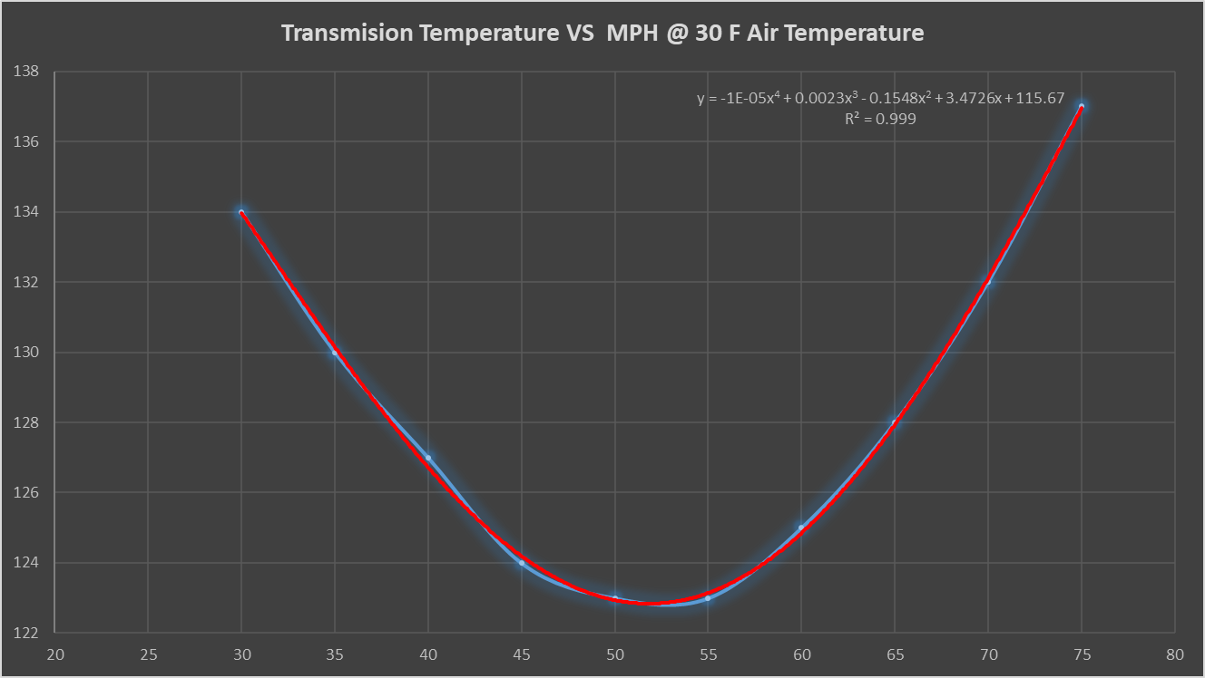

Lates Updates
8/24/2023
I continue to collect data on Pepper and the modifications I make to her.
Note: This is a 2015 V6 NON-NHT truck so the ATF cooling is by an exchanger in the radiator COLD tank or passenger side as a standalone cooling system. There is no air to air on this truck. 95F days ATF ran 195 to 225F and higher when stalled in wreck traffic or in the city stop and go.
1.) First enhancement was a more heat tolerant fluid and one with a higher thermal capacity and conductivity. Red Line's D6. That was good for about 5F.
2.) Isolating the best speed for cooling was next. This proved to be 50-55 mph. Runs hotter if speed is more OR less.
3.) Lower water thermostat. Four total tried including the factory 207F, 194F the aftermarket 180F and 170F in a few configurations. This was huge. More so than I thought at the time.
4.) 8-quart PML finned pan. More for ease of fluid changes then heat rejection. What it did do was speed recovery of temperature when it spiked and delayed heat up. Just more fluid to heat and cool and more surface area to work with.
5.) Pill flip came next, and the full effect of the colder water thermostat became apparent. Those would be the orange and blue lines. Total effect was knocking 60F out of steady state fluid temps at 55 mph. HUGE. But it took a long time to heat up in cold weather and used more fuel six months a year. And I lived with that until GM release the 70C TBV.
6.) Install 70C TBV. Warmer in the winter. Throttled nicely in air temperatures between 55F and 77F.
All this revealed the FACT that even with all of this that I still don't have enough cooling to maintain throttling temperatures when ambient exceeds 80F or enough to tow anything and maintain a safe ATF temperature. More cooling is in the works. Exploring a second stage air to air AND the NHT radiator.
So, you may be asking, Jeez Louise how cold do you wish to run it? Cold enough to maintain the throttling the TBV is DESIGNED to provide. Mid 140'sF. During the hardest service I expect to see. I'd also like to see the hot soak temps not to exceed 160F. Right now, that is limited to 55 mph and totally unloaded.
I can measure no impact on MPG over the multiple years I've been running this down. Now off to collect more data. It's a hot one today. Rare opportunity. 😉
